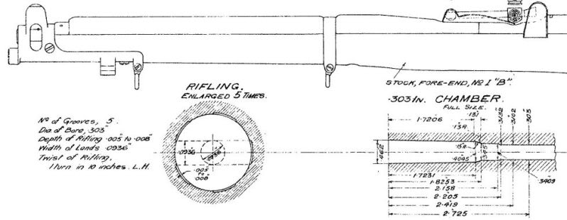

I’m sorry to say an American captured your secret documents on the No.1 and No.3 Enfield, its amazing what a bar of Hershey Chocolate and a pair of stockings can get you from a lonely female during a war. ;)
No.1
https://www.milsurps.com/images/impo...SAID2267-1.jpg
No.3
https://www.milsurps.com/images/impo...AID20581-1.jpg
If you Brits had been on guard duty instead of arguing with a few American arm chair commandos I never would have gotten in the MOD Pattern Room Library.
Sincerely
Ed Horton the “friendly Yank” :D
P.S. Last week I captured Caen (twice) :rolleyes:
https://www.milsurps.com/images/impo...hot0000a-1.jpg
Has anyone ever seen a fired .303 case with a shoulder that looks like this drawing?
"Depth of Rifling .005-.008", now thats 19th century quality control standards for you.

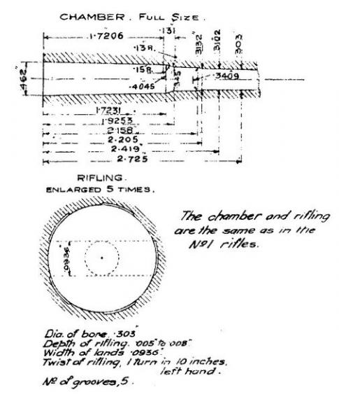

Ed's drawing v. CIP
Comparing the chamber dimensions in the drawing provided by Edward Horton with CIP chamber dimensions, I find a noticeable discrepancy.
Chamber MIN diameter values: (
CIP P1= base width = 11.74mm = 0.4622" / Ed= 0.462"
CIP P2 = start of shoulder = 10.25mm = 0.4035" / Ed = 0.4045"
CIP H1 = start of neck = 8.76mm = 0.3449" / Ed = 0.345"
CIP H2 = case mouth = 8.66mm = 0.3409" / Ed = 0.3409"
So far, so good. Near enough the same.
Chamber MIN length values:
R = headspace = 1.63mm = 0.064"
L1 = base (= bolt face with headspace R) to shoulder = 46.04mm = 1.812"
L1 -R = rim to shoulder = 1.749" / Ed = 1.7231"
L2 = base to start of neck = 48.06mm = 1.892"
L2-R = rim to neck = 1.828" / Ed = 1.8253"
L3 = base to case mouth = 56.44mm = 2.222"
(which is, incidentally, the exact value stamped on the chamber of my No1MkV, other Enfields I have seen have 2.22")
L3 - R = 2.158" / Ed = 2.158"
So there is a serious discrepancy in the length to the shoulder. A cartridge made with the cartridge (MAX) rim-shoulder length of 1.749" would be impossible to chamber in a chamber that only allows 1.7231".
And before someone points out that the sharp corners in the drawings do in fact have rounding radii that are also specified, I must mention that I know that, and the difference between start/end of the radius portion does not seem to be enough to cover the discrepancy. (L1 and L2 figures are taken to the intercept point of the straight lines).
I have presented these figures in the hope that one of you can compare the values with SAAMI and either point out my mistake or explain the discrepancy.
Patrick
P.S. I've got it! It was a cunning trick by the wily Pattern Room to let Ed grab a deliberately erroneous drawing so that if the Yanks had the brass cheek to copy the 303 they at least wouldn't be able to use our ammo! An early example of disinformation? LOL.
OK Ed, the ball's in your court. Please pat it back gently!
Patrick
>>>And before someone points out that the sharp corners in the drawings do in fact have rounding radii that are also specified, I must mention that I know that, and the difference between start/end of the radius portion does not seem to be enough to cover the discrepancy. (L1 and L2 figures are taken to the intercept point of the straight lines).<<<
Normal drawing practice usually states such a dimension is to the theoretically sharp corner. The sharp corner is easily found with an optical comparator.
My questions about both CIP and British pattern drawing would have to do with the following
What are the tolerances and for the British specification is it a minimum or maximum chamber?
What are the minimum and maximum cartridge drawing values.
