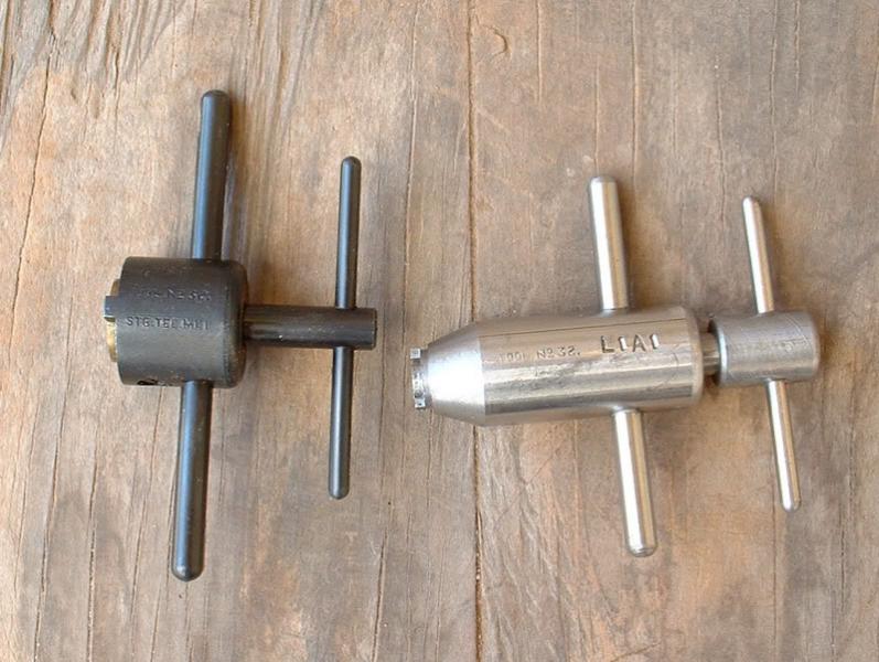

Make the tool from an old Allen wrench. Mine's been serving well for almost 20 years.

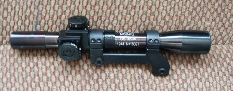

I received my No32 repro from gunpartscorp a few days ago. The glass is nice, clear right to the edges. Haven't had a chance to test repeatability. There are several distinct differences from the original so if you have adequate knowledge of the No32 you'll see the difference.
I've seen several different scope serial numbers now.

The one on the right is like something from outer space............ I've been in the UK Military small arms system for a couple of years and never seen anything that looks like that. Surely someone isn't passing these off as original are they? The one on the left looks like the original but I never ever saw one used, not even as a basic stripping tool in the Instrument shop in the era of the Mk2's.
This subject of the Mk3 tool is becoming a hoary old chestnut! I bought a No32 Mk3 via an intermediary about 20 years ago. It came from a retired armourer who had made a tool as per the one shown at right for his own personal use when working on scopes. I subsequently had the late Graham Smith make up three or four more & MJ1 acquired one from me. There is no mystique to them. That is all there is to the story. Incidentally, Graham took it upon himself to add the markings. I have found mine useful at times but have never for one moment suggested that it is an official issue item (the one shown was made about 7 or 8 years ago). Unless someone has started copying the copies then to the best of my knowledge there are about four or five in existence, two of which are in my garage!
