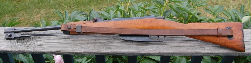

New photos in natural light and the new sling.

:thup:Carbine envy!
You've done a rare thing...
Aragorn243, a very nice original sling using the German-style buckle intended for use on the Italian submachineguns but seen in period photographs in use on Carcano short rifles and carbines from the end of WW2 and into the post-War period. You did well and showed excellent perseverance finding it. Congratulations.
