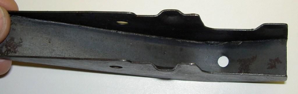

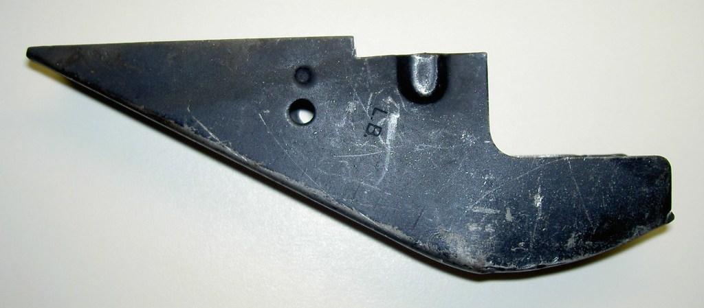

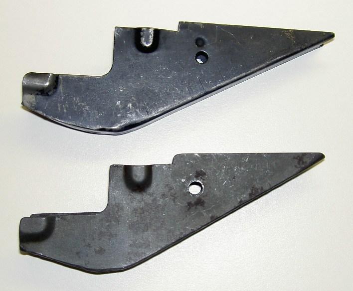

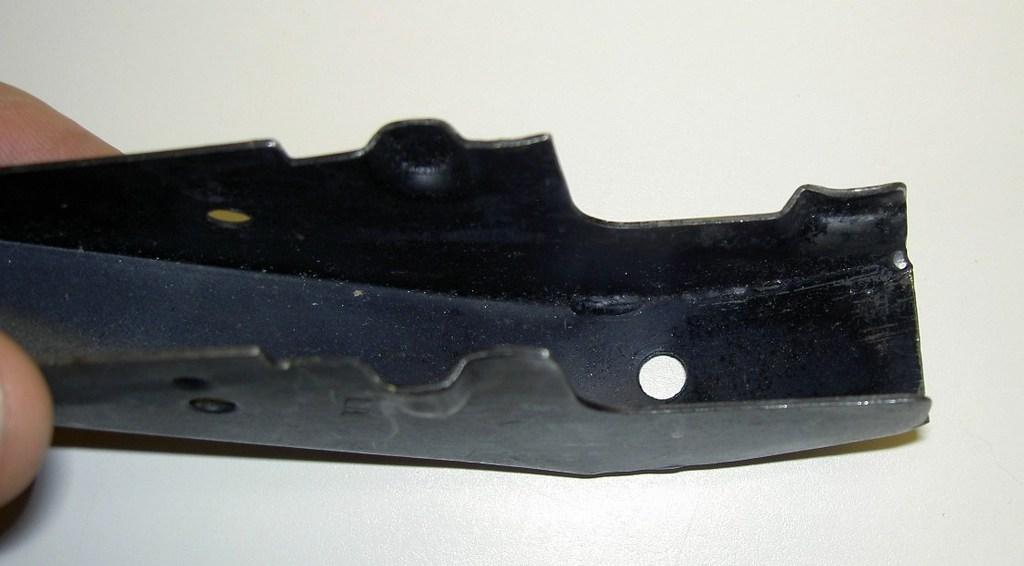

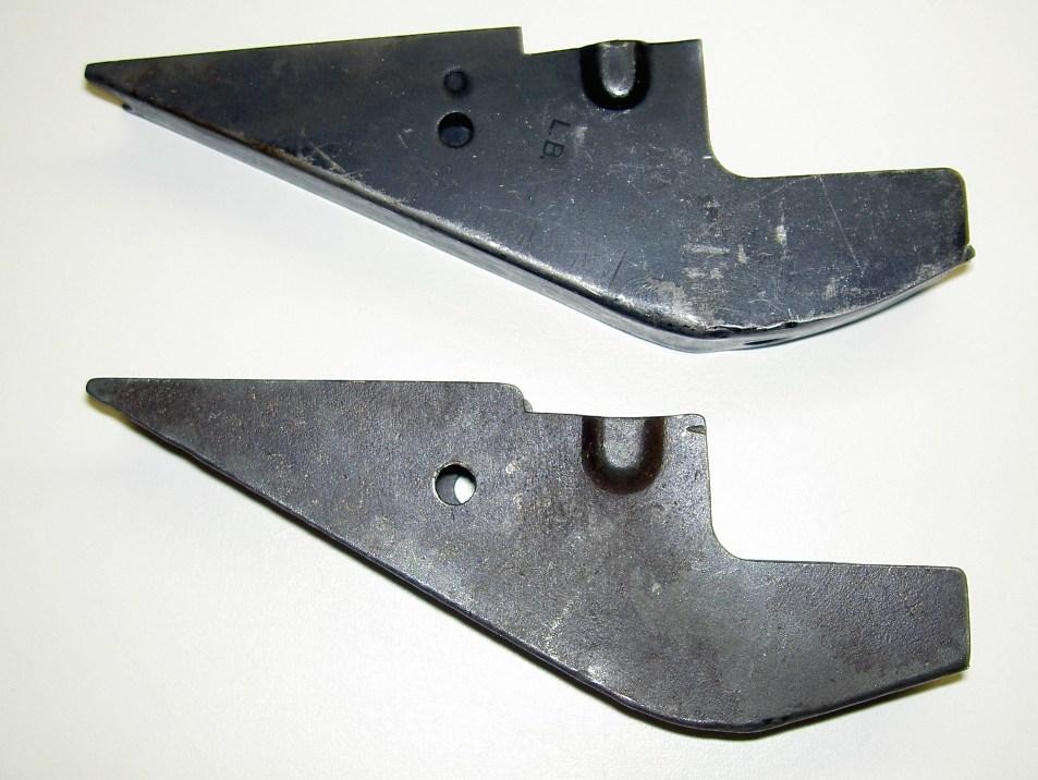

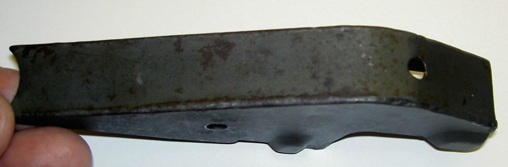

I understand your interest as a toolmaker in how these covers were made. I don’t know much about stamping parts, so it’s interesting for me learn from someone who does. I do know a little about welding and whoever welded this Haganah cover was very good. Remember, this was done before TIG welding was widely available. The steel is only 0.036” thick.
Here are some pictures of the Haganah cover and a MK3 Sten cover made by Lines Bros Ltd.

As you can see, the Lines Bros cover was made with rear welded. That’s interesting to me because they were very good at stamping.
