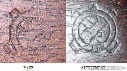

Good God! Rick, once pointed out, I see it. I knew the "S" were bad.
Printable View
Let's see if I learned anything...fake - center V of the M is too high. Oh by the way the start for bidding is $900 on Gunbroker
https://www.milsurps.com/images/impo...49151531-1.jpg
You did good and there is allot wrong with this one. Sad :crying:someone will pay big bucks for it. Rick B
I think the worst thing they ever did was blocking people from contacting the bidders. Bidders that don't know should be educated. They should be required to take a course here and learn before bidding! :madsmile: :lol: :dancingbanana:
OK, now even I can see this is a fake... :beerchug:

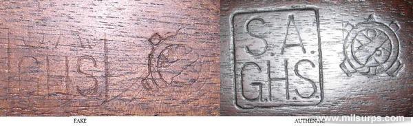

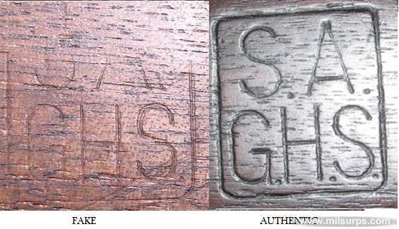

Ok # 7 is a Fake also. This one when looking at it at a show or by itself can be a hard one also as they burned it in to give it the aged look. The key here is the letters height is how I lined these two up and that shows allot of differences in size before you even start to compare other points of this one. Rick B
