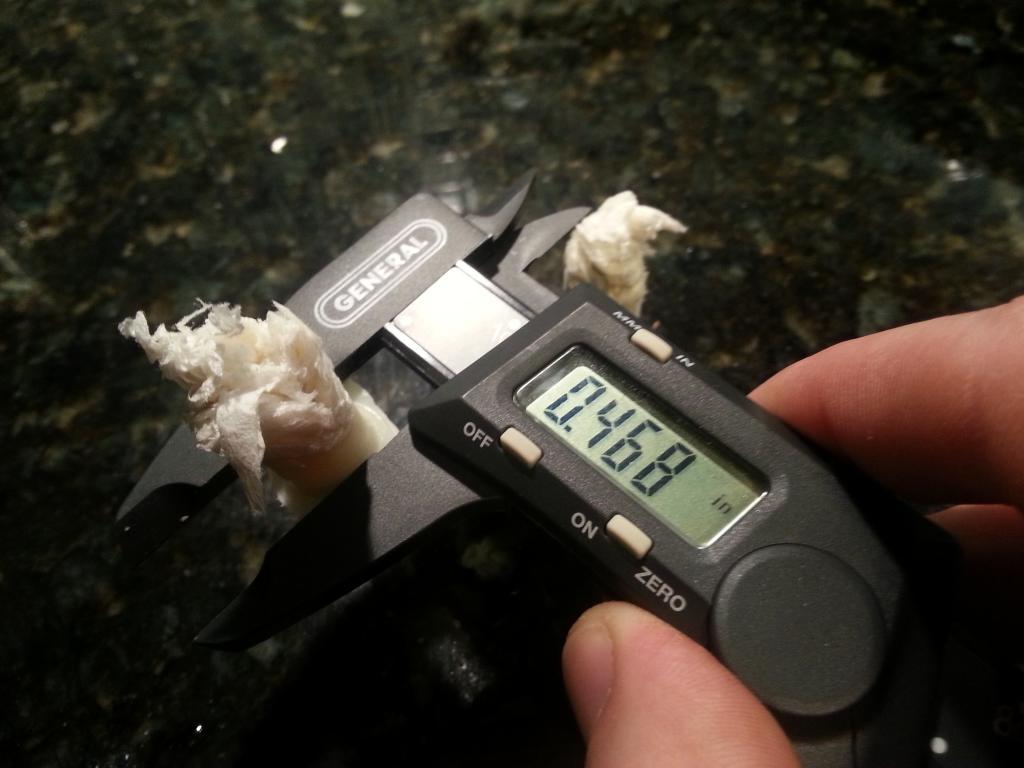

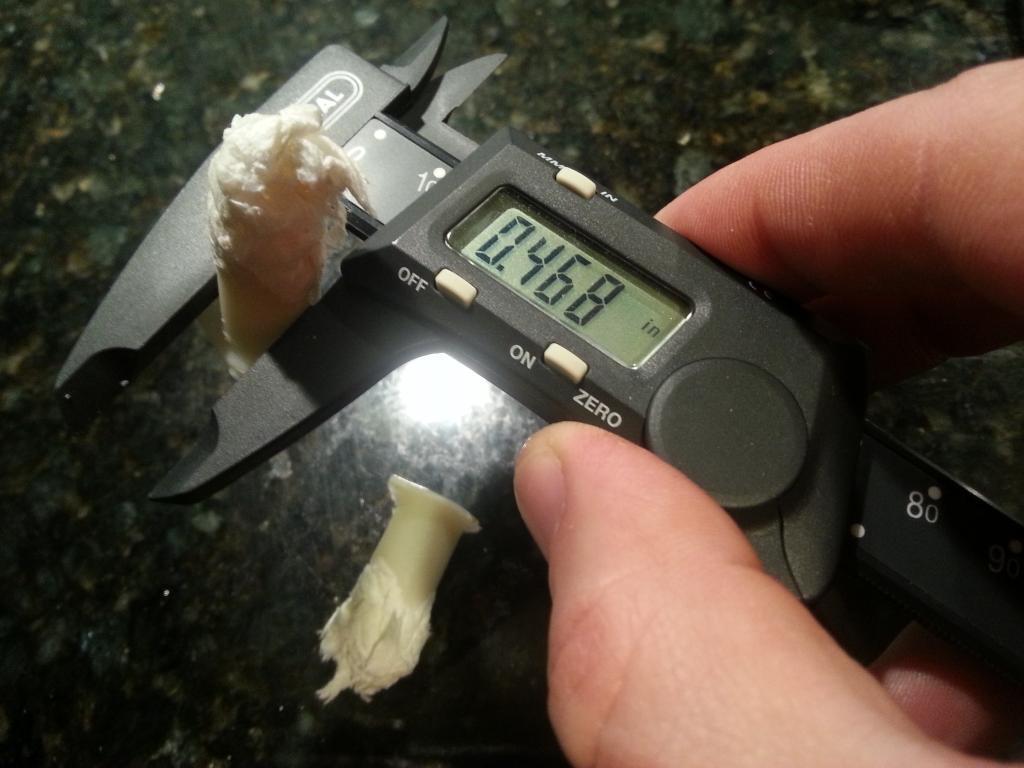

@dttuner: Can you give your measurements in mm too? I see you can change the settings to mm on your tool.
@Peter Chadwick: I was thinking about one of the old 11mm revolver calibers too. But the depth (2,238) of the chamber is not correct. Maybe the chamber was changed at one point?
Wow! 2.238" = 56.8mm.
That's a real rifle-cartridge length. Far too long for a pistol.
BTW, where does it say that the chamber depth is 2.238" - I can't see it?
However, there may be some uncertainty as too where the chamber proper stops, and where a possibly burnt-out throat begins. From the photos, the chambers do not seem to be well-defined.
Dttuner, I suggest you take a piece of wood dowelling turned down to 0.46"/11.7mm and see how far you can insert it into the chamber.
