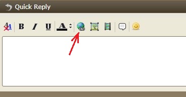

Thanks Charlie! To save confusion I'm really going to have to have the wife show me how to post links into this forum. I can post links to email and in private messages but this forum is never one of the options I see to post it in. I hate being computer ignorant haha
Jon, if you can see the icon on your phone with the red arrow pointing to it - it will open up a space for you to insert your link. - Bob
Attachment 130176
