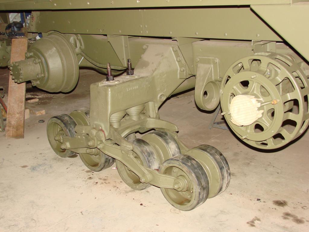

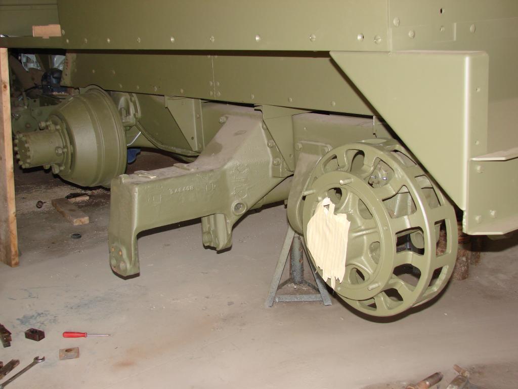

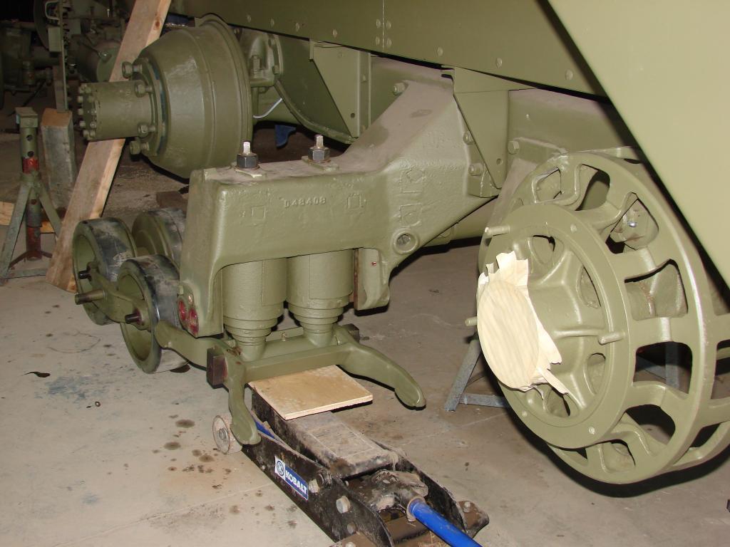

When you see it in its stripped down form, you can appreciate how short the gearbox to drixe axle is AND how safe it is, out of harms way. GREAT work Andy. Now that you've found that extended family, get one of them to work on formulating that book..........

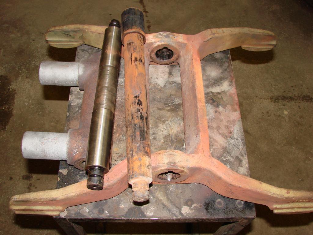

On another note was at macine shop and they got the rear crabs apart with no damage. Should have them back next week
Update time yet?
Here is what I had been waiting for from the machine shop. That is the crab assembly. That rusty pitted shaft had to be pressed out, and it didnt go easy. I had NOS shafts and bushings to go in, that was the easy part.

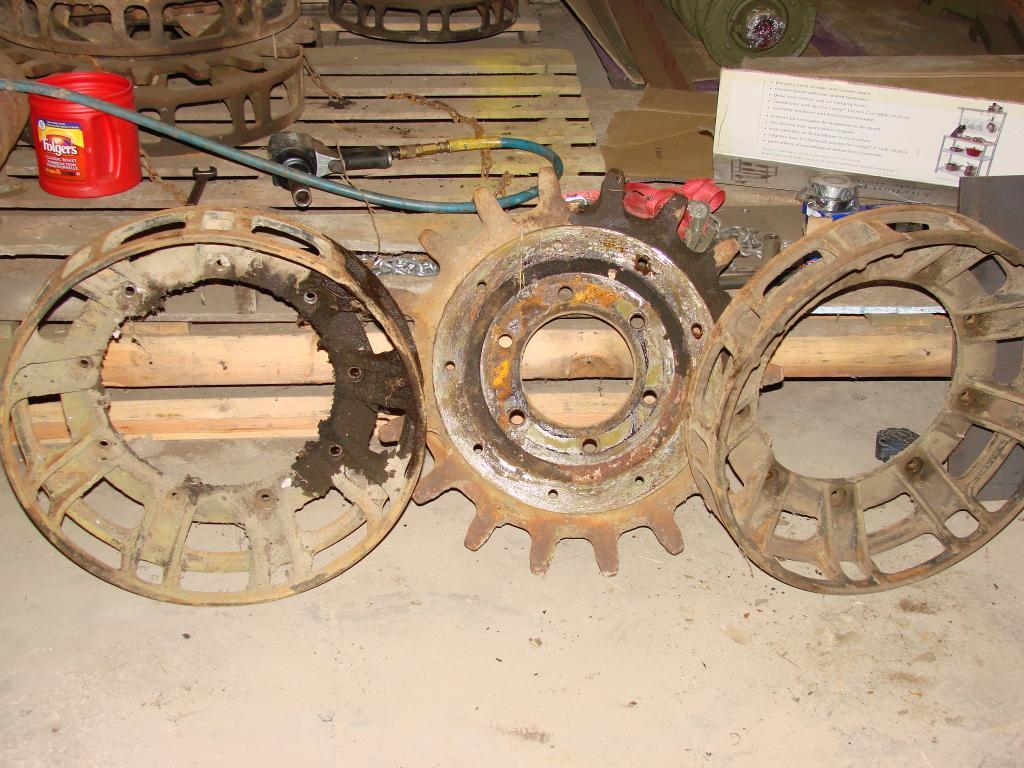

And this is the drive sprocket apart. Exactly like a tank drive sprocket. They wear at the front of the tooth, and they can be reversed after too much wear. The ones that came with my halftrack are perfect on one side so i will use these sprockets I got out of Ca;California with my rings

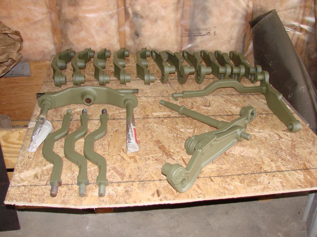

Most nuts and bolts/studs were fine, but some had torch marks from previous owners that im sure would work fine but looked like crap, so i got new ones of same style to replace

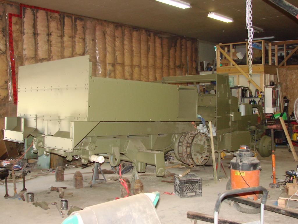

Sorry guys been a while. Farm and shop work has kept me busy. Since the cold weather has returned I have put the burner on to finish up prep and paint of as many parts as i can. Pics soon. Also waiting on another parts shipment with more suspension stuff.
BTW Claven, I did send then resend pics of the gas tanks test fit. As usual it wasnt a easy go, hole on drain at bottom was of on both by 1/4 inch lol, so out with the plasma cutter to open up the hole on the track armor where the drain hole drains from. Then grinding, repriming and repaint the painted area lol
