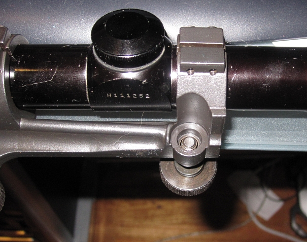

Reproduction scope and mount are not in alignment with the barrel bore
I put the reproduction scope and SARCO reproduction mount on a naked L42 that has been setting on the rack looking funny without a telescopic sight for the last fifteen years.
The scope went into the mount with no difficulty and buttoned up with no problem. I put it on the rifle and set up a Busnell Collimator to evaluate the sight vs. barrel correlation.
I was able to confirm what Peter has said many times in the past. The scope/mount was not in alignment with the bore. The sight picture is off set to the left further the scopes' ability to shift the pointer into alignment.
I will try a few other mounts and naked rifles to see if I can find a combination that works.
