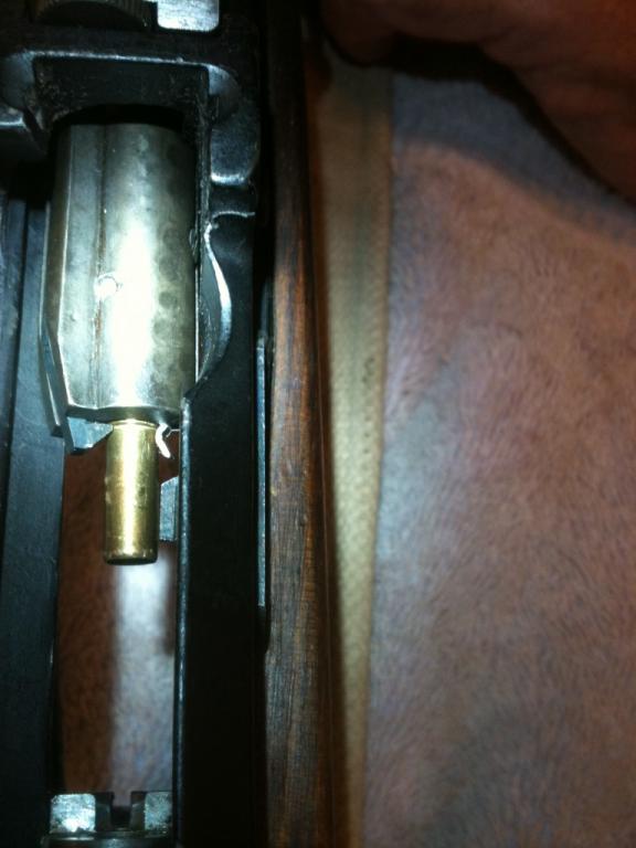

We now have the ejector plate in our possession and hope to produce enough to complete the bolt heads we have. I can see why it isn't cheap. Andy says it will take about 28 separate operations to make one part. When he saw it he said he wasn't even close to what he thought it looked like. Glad we have this part in hand . Special thanks to Neil in south Florida !!
I know it's not my shout Dave but from the pure production engineering point of view, surely the ejector would be far simpler if it were a fabrication of the main, flat, drilled/countersunk plate with the ejector silver soldered in place.......no? There is no actual 'load' as such on the plate or ejector part if you don't count the actual ejection load which is barely measurable, even with the most ham-fisted user.

I'll pass that on to Andy as we were planning on making it out of a solid block of what ever type of metal our example is, but my non engineering mind thought why is this ejector so elaborate when all it does is knock a 22cal casing out, wouldn't a simple rectangle post do the same thing? The great thing about this project is we are not talking 30 cal and high pressure here so we rest at ease on the safety part of said project. Thanks again Peter and all the best to you and yours this holiday season.
