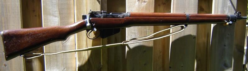

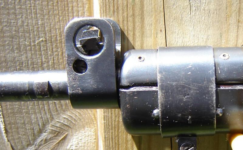

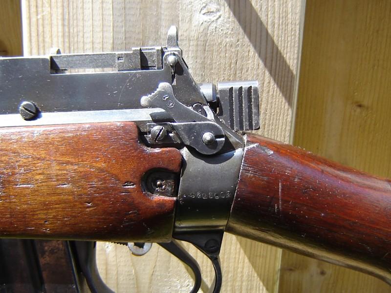

Here is my 1950 Long Branch That I just aquired
Serial number 92L1902 all matching.
https://www.milsurps.com/images/impo...DSC05930-1.jpg
https://www.milsurps.com/images/impo...DSC05935-1.jpg
https://www.milsurps.com/images/impo...DSC05932-1.jpg
https://www.milsurps.com/images/impo...DSC05934-1.jpg
