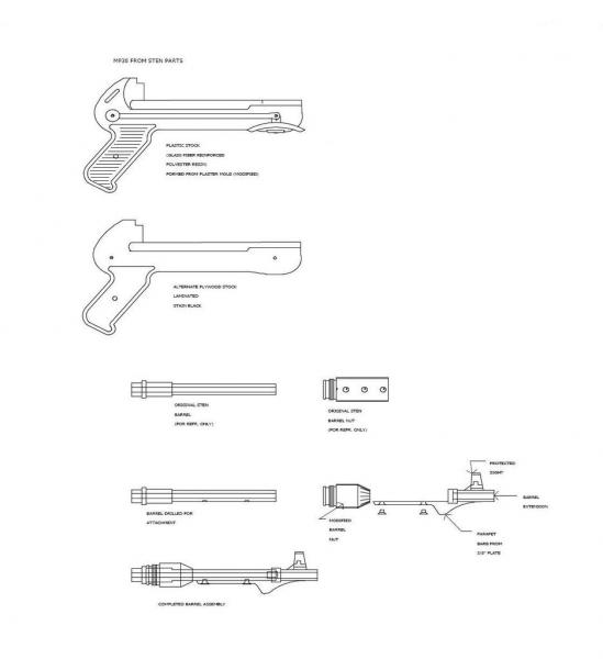

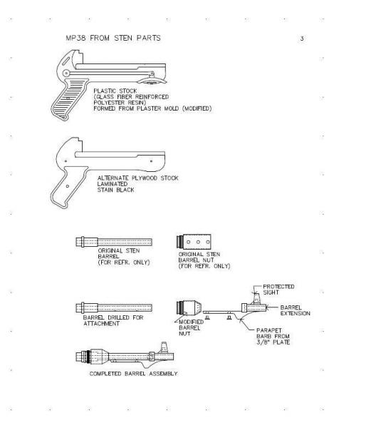

Known variants we know we can make from the SAS-3 kit + parts kits are :
-Sten Mk3
-Sten Mk2 (for the moment the ONLY one with a FRT number)
-Sten Mk V (If you wish I might ask for permission to post pictures of one build here)
-R-5 Gnome-Rhône (well if one feels like it is possible I'm sure.)
-MP38 look-a-like

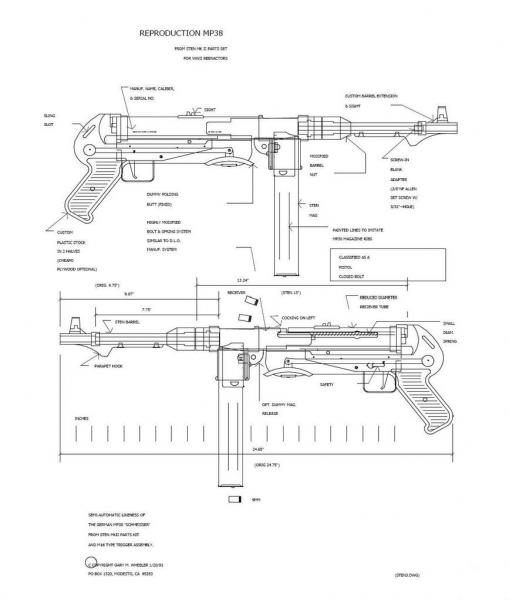

" A WHAT? " Will you say. So as words are good but pictures are better yet, take a look!
https://www.milsurps.com/images/impo...1991DWG1-1.jpg
https://www.milsurps.com/images/impo...1991DWG2-1.jpg
https://www.milsurps.com/images/impo...991page4-1.jpg
https://www.milsurps.com/images/impo...991page5-1.jpg
https://www.milsurps.com/images/impo...991page6-1.jpg
Who knows, maybe the idea is worth digging. What do you think? (comments please) By the way, I have the same images in .pdf format if anyones want 'em please PM and I'll send it (as long as we can insert attachments on PMs here.) Or give me your email so I email it from my personal email.

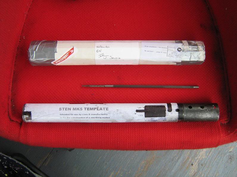

Now, a question that might just be of interest for those who still hesitate to begin their SAS : Is there any place where to find a template that will NOT need to be touched-up ? Those that are available on the web all seem to need the charging slot placed lower on the tube and a few other minor but still needed modifications. Even the templates from Luna and Diablo's will NOT work with the SAS-3 kits. I know, I asked them in an email and they said so.
J. Savoie
You might want to try prexis sten. They have a mkII template available, but you may have to pay a nominal fee for it.

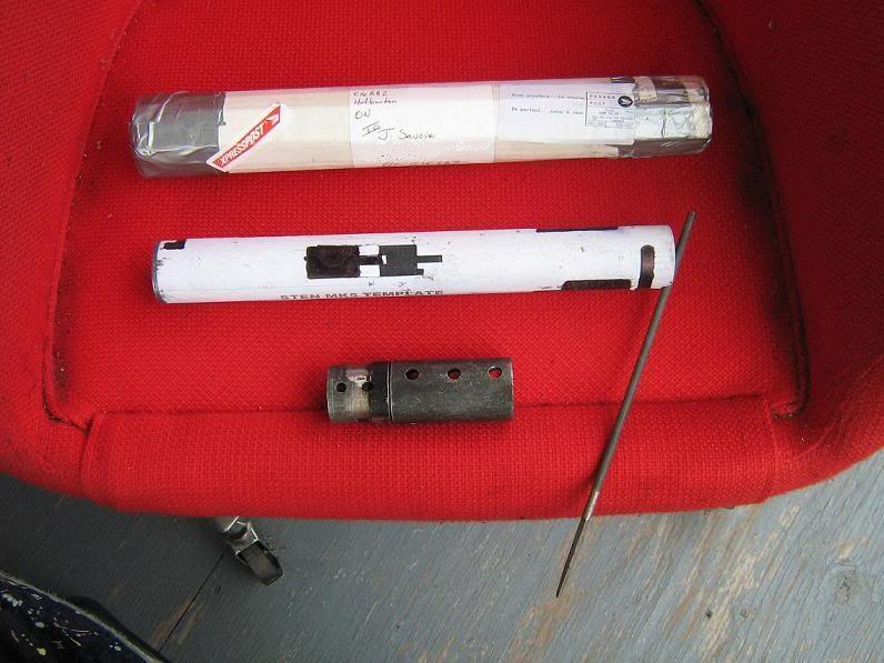

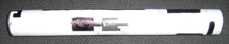

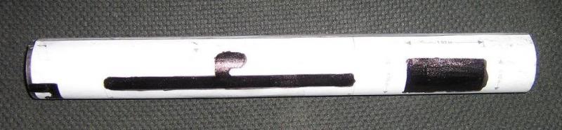

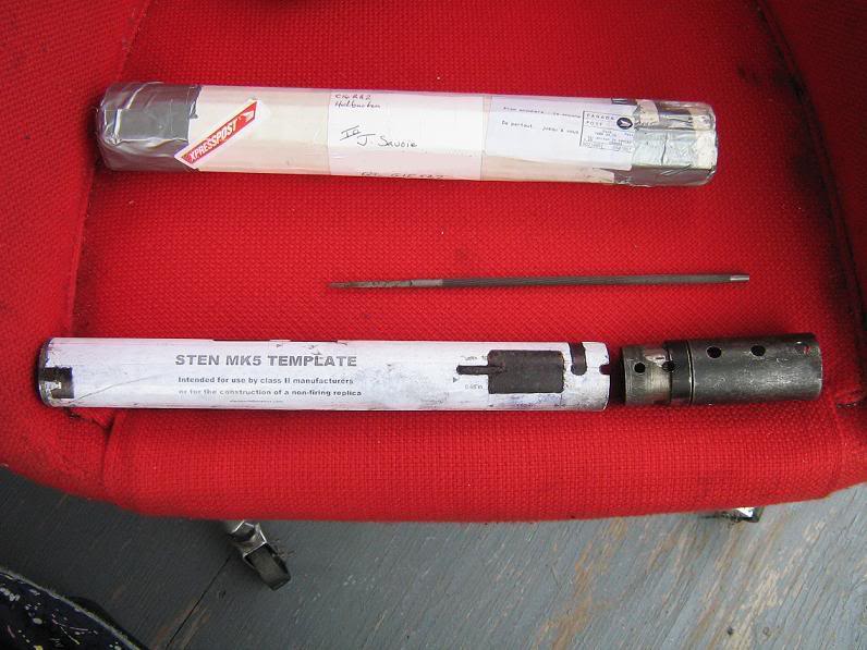

Meanwhile, after having had to touch-up many times the templates available to me to finally have one at the correct dimensions and having practiced my cuts on a cheap muffler pipe, I finally glued on a template that was A-OK on my “good” tube.
I will still have to cut the openings and then make the 2 halves of the magazine well not forgetting to take PLENTY of pictures to join to my application to register a firearm (frame only). Then, when I’ll have received my cert., I will put it all together, WHEN I’ll have found a bolt kit (which I have plans here) and an 18½ inches barrel.
I must expect to be asked to send the final product but hey, it is the last of my troubles so much I am expecting it to be compliant to our laws. Oh sure I could have made the original barrel cut and rebuilt (i twas torch cut) but I wand a non restricted firearm so …
Note here how I had to displace the sear opening as on the original drawing.
https://www.milsurps.com/images/impo...Photo042-1.jpg

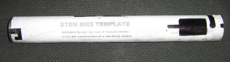

I pre-cut the sections to be cut on the template so when I make my cuts, the drill bit won’t tear off the template. Then I colored the bare tube with permanent ink pen as I did not have machinist blue or else I would have used it instead.
https://www.milsurps.com/images/impo...Photo044-1.jpg
As you can notice, the original template came from a Sten Mk5 template.
https://www.milsurps.com/images/impo...Photo043-1.jpg

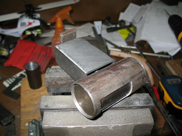

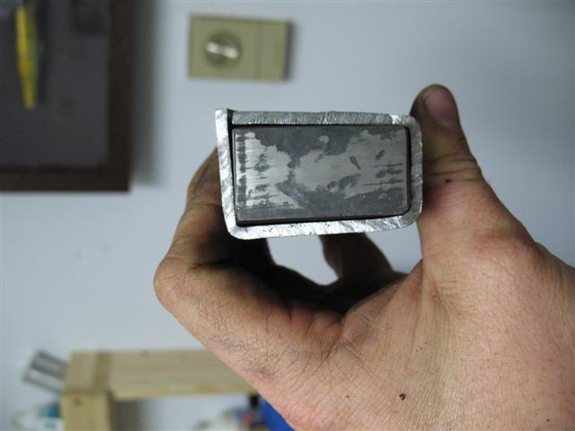

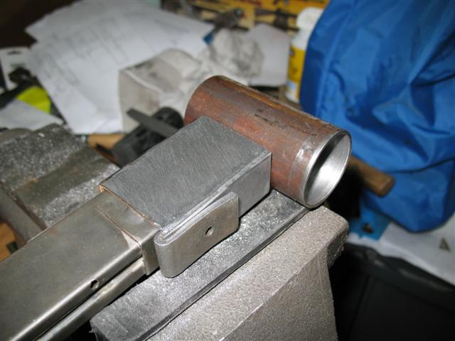

Today I finally began working on my SAS tube. There are the 3 simple steps I made. I am keeping from doing more work for now as I still don’t have a bolt conversion kit nor an 18½ inches barrel blank at hand.
I already had a rat tail file that was just the right size for today’s job. https://www.milsurps.com/images/impo...08/07/01-1.jpg
https://www.milsurps.com/images/impo...08/07/02-1.jpg
https://www.milsurps.com/images/impo...08/07/03-1.jpg
