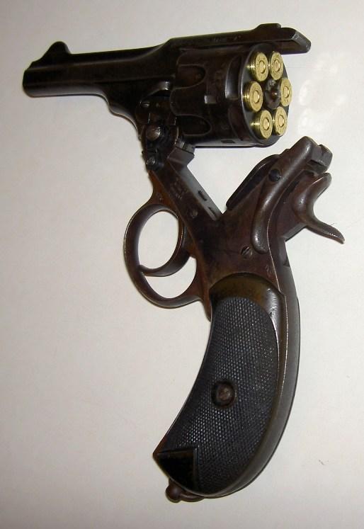

Here are my MkIII and MkVI with a picture of the hinge pin screws removed. On mine they are interchangeable although the screwdriver slot on the MkIII is slightly wider both fit either revolver equally well. I can come up with length, diameter and TPI if needed. Tom
Thank you, Tom.
Those dimensions would be a great help.
