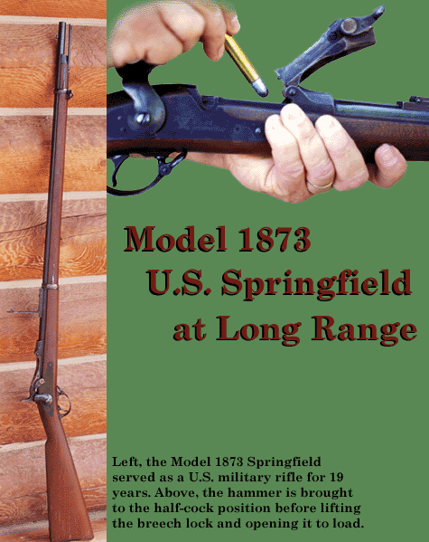

I like soft bullets also, BUT... (see this article from RIFLE)
I have had excellent success with CAREFULLY made harder bullets.
In fact, this guy used wheelweight bullets at .4585 amd got excellent results also (frankly, I think lube is just almost as important).
But, just in case you don't want to read the whole article.
Nice TD rifle, wheelweights and 20-1 bullets around 500 grains, and smokeless powder = excellent results.
(and I also have had VERY good results with fairly hefty (but safe) loads of Varget. In fact, the most accurate and consistent CAST lead bullet I have ever shot in TDs is a Cast Precision 480 grain GAS CHECK bullet at .458 wth LBT blue lube.
Frankly, there is no ONE "best" ammo. LOTS of stuff "works."
However, my two basic suggestions are well-made 500 grain bullets, or the Remington 400 grain jacketed soft point. For the Rem, I would go with IMR4198 and for the lead bullets, I would go with Varget first. For BP shooting, almost any typical typical soft well-made bullet around 500 grain and all the other BPCR stuff (i.e. drop tube, slight compression, veggie-wad, etc.) yield very good results.
