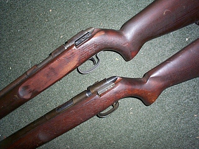

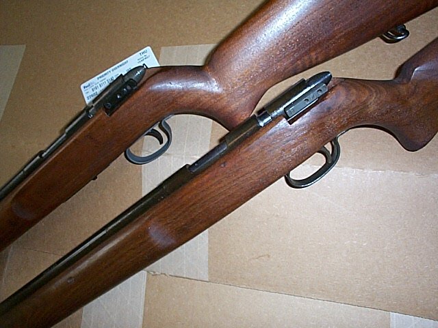

there is nothing "magic" about restoring a military oil-based stock finish. Arguably, the only "finish" on an oil=impregnated stock is GRIME and OIL anyway. Most of the other methods will either take WEEKS and yield a fairly poor look, or won't work at all.

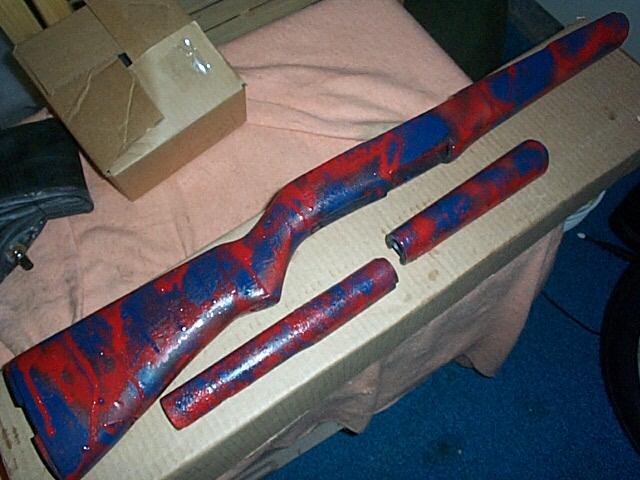

of course, you can always PAINT the stock as another option! LOL

and I have used Oven Cleaner on HUNDREDS of stocks also. Caustic Lye is what was USED to refinish/strip wood for a few hundred years, I think having a can of OCleaner on the shelf beats having to keep a "tank" of chemicals in my garage. there are usualy several ways to efficiently skin a cat, and with common sense, oven cleaner works extremely well. In fact, oven cleaner methods was taught to me by a German guild trained gunsmith.
