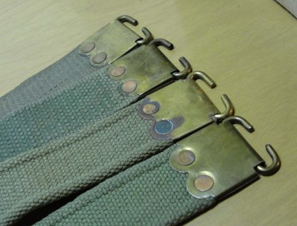

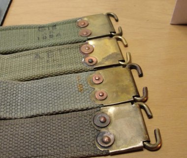

Would these be the Mystery Slings?
Two minor varieties with identical brass ends, one with unribbed web edge, one with a slight rib.
One sling seems to be marked "ABL" over "??" over "1954" and another "GIE" over "AL" over "1954"---these are the two with the slight ribbing. The thinnest type I have never found marked. I think the end tabs tie these two types to the same source, by the way.
So, Belgian?
https://www.milsurps.com/images/impo...75796126-1.jpg
https://www.milsurps.com/images/impo...75796125-1.jpg
-----krinko
ABL is definately Belgian and they still exist to this day, still bidding for UK MoD webbing contracts. Nylon is a bit of a no-no currently as it burns ans sticks
Peter, do you have any idea of the origin of the narrower nylon slings? Century had many of them for sale but since they were so dissimilar to the correct English sling and wouldn't hold adjustment I only bought the two, site unseen. I had no use for more since the General Service Sling was easily available at the time. I remember that the polyester and nylon uniforms and webbing fell out of favor VERY quickly after fire related experiences during the war in the Falklands.
