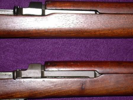

It looks to me as if it's a high-wood that's been arsenal modified to 'low-wood' configuration.
(Unless, I' am misunderstanding completely, which never happens to me!) ;)
https://www.milsurps.com/images/impo...odontop1-1.jpg
That top one looks as though it was damaged and then filed or sanded. That is not a clean looking high wood cut. Mikey51, yours was modified and cut down to low wood. An I cut stock was always originally a high wood.
It was only for a quick comparison of the difference of the two designs, Wulf. (It's only a file photo)
Yes, they often had to repair/sand high-wood stocks that became damaged. That's why later stock designs were changed to 'low-wood' and many original 'high-woods' were also modified to the 'low-wood' design. (They weren't very considerate for future collectors!) ;)
As stated by some of the others..."I" cut stocks were always originally high wood stocks. Sometime during the life of this stock, though, it was modified to the low wood configuration. You can see the difference in the picture posted above. It's still a nice stock.
