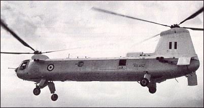

Can any of you RAF types identify the helicopter that it's mounted in? We had those Belvedere thinggies in Malaya and although I never knowingly flew in one, they just looked about as aerodynamic as a piano to me. They flew everywhere with 6 or 8 of those huge 44 gallon containers full of petrol lashed into the front of the working bay, presumably so that they could decant it if they ran out of petrol. I know that when they landed close to civilization, they had to have a proper fire-engine present unlike everything else where you just had a wheely-bin like fire thing. I remember being told that a fierce tracker dog got loose in one once, got a bit frightened (they went everywhere in the helicopters.....) and went ape-sh-t. Snapping and snarling and biting all and sundry until one bloody and even angrier Maori jumped on it - in mid air no less - and throttled it to death.
Yes......... what helicopter is it?
Looking at the space available, it could even be a airplane rather than a chopper.
Is the rank badge on his wrist any clue?
The badge looks like a Air Load Master wing on a Warrant Officer badge or Flt Sgt as I'd expect ALMs with the rank of Sgt to have woven cotton badges. With me being a current RAF NCO I dont recognise these older badges.
https://www.milsurps.com/images/impo...elvedere-1.jpg
I think the the Air Load Master has the Bren sticking out the Port window that can bee seen to the rear of the helicopter in front of the rear engine/rotors.
The "Belvedere" was withdrawn from service in March 1969.
Info taken from http://www.aviastar.org/helicopters_..._belvedere.php
Mmmmmmmm........, I remember now why I always thought that they were about as aerodynamic as a piano. If I remember correctly, they had a big side door too, where they loaded on their return petrol supply, in big, blue 44 gallon drums. Frightening!

You're right there Peter. There was a big sliding cargo door on the starboard side.
