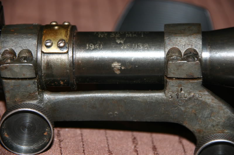

Except for the pads and the hex thingy it's all good. The hex thingy may be good too, but I don't know what it is! If it's a scope zeroing tool, I don't THINK it's for a No.32.
Your scope is VERY early. The number on the bracket matched a rifle's S/N at one point. It was never matched to the scope S/N. As an interested party for purchase, I best recuse myself from valuation, but even w/ the brass bits in an unnaturally bright and bare state, it's gonna be a fair sum...

That is telescope number 138 (they all started at 1000 except for United Instruments/Vickers). I'd like to see the number of the rifle on the box.....................

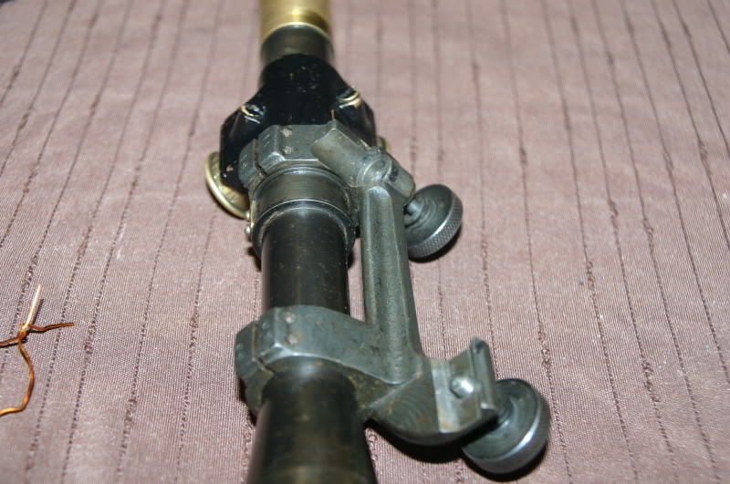

1 Attachment(s)
As Peter said it's a very early scope. Would have been on one of the trials No4's converted at RSAF Enfield in 1940/41 originally.
The bracket is a bit later, but it all looks perfectly genuine to me.
The scope has had a sympathetic restoration with just the drum "turret" and screw heads painted. Note the missing locating pin.
The paper label in the case looks to read RIFLE No. AQ7240 and TELESCOPE No. 5420. I could well be wrong of course! Ah, hang on, looking at the lid, it looks more like AQ7540.
The adjusting tool, if that is what it is, I would guess was made up somewhere to expedite matters. Was there a handle fitted to the end we cannot see? Note the photo of a tool that was one of a small number made up as explained.
Would "W.I.D." be "Weapons Inspection Department/Directorate"? The patina certainly suggests it is as old as it claims to be.

I'd say the bracket is correct for the scope, based mostly on the unusually good "finish" (this one's a bit sub-par) that seems peculiar to early brackets. But that's just a SWAG.
It is also not the only early scope I've seen that has been apparently reassigned to a 1944 vintage weapon. (tiny sample size of four+, to date, so NOT definitive!) I'm thinking that for some reason, production bottlenecks perhaps?, some of these early optics were pulled off rifles (presumably U/S or otherwise not intended for further field work) and reassigned. I think I have mentioned it before. It makes reuniting early optics all that more difficult, if true, as there will then be TWO "proper" rifles for each scope.
As the screws on the ring caps are not staked and there is no patina around the rear ring on the scope tube, my guess would be that the scope and bracket have not been together that long, at least never in service.

Regarding Surpmil's observation about the missing locating pin in the index plate. This leads me to believe that these turret heads are not the correct ones for this telescope and have been changed. They LOOK like they've come from an HBM scope.
WW telescope drums have very shallow engraving, engraved with what we used to call a 'scratchy pen' through a layer of 'corrosion' then covered with a wipe of soft solder. After this. ithe corrosion is removed with an acid based mix taking the solder with it which just leaves the bright brass and a VERY shallow lead filled set of figures. It's then chemically blacked, THEN heated to the melting point of solder and the now silver numbers show through the black. As a result, if you try to highlight these drums later, you'll see JUST how shallow the engraved marks are. That's probably answered a few who wondered how it was done
The HBM drum turrets are altogether different. Deep, perfect engraving. Just as you'll see here. As a result of this, the locating pins don't match up so have been left out. Nothing wrong with this as it's a fact of life in service.
The pins are particularly important on the deflection drums because if the lead screw is not EXACTLY aligned with the cursor slide as the front ray shade is screwed up, then it'll tighten up and stay 'screwed up' as they say. Tha's why the screw holes are quite large in comparison to the screw heads as this gives the index plate afair bit of wiggle room

Interesting. IMHO all is correct but disparate, as others have said. I would go with surpmil in his view that the bracket & scope have not always been together. The serial of the rifle stamped into the bracket is a BSA 1944. Some late Mk1 scopes were definitely fitted to 1944 BSA's --- I've owned two, but they were high serial numbered Watson's that were dated 1944, rather than earlier manufacture scopes. I'd be keen to see a matching T that is of later war mfr with a truly matching 41 or 42 dated scope.......they may be about, but all those I've seen to date were lash ups. I'd be interested to see pix of rifles with scopes pre-dating the rifle that are 'correct' (at least rifles & scopes of UK mfr). All those 4T's that really were genuinely matching that I've seen to date, where they have dated scopes, have have had scopes dated the same year as the rifle or later, such as a 44 scope on a 43 rifle, or a 45 scope on a 44 or 45 rifle. It makes sense as the rifles were always in far greater supply than the optics............But I'm open to persuasion!

I've seen quite a few dated ones where the date has been amended by over engraving. Same as updates from Mk1 to 2 spec. There's no doubt that this set-up is made up from the sum of its parts but I firmly believe that the telescope is a 'bitza' too. I've seen inside one or two and I wouldn't mind betting that the telescope is the sum of the parts too. Only my opinion though, sharpened by the previous comments.

The misalignment of the square range drum "cover" and the missing pin, might well mean that those parts were pulled out of another scope and inserted in this one as a quick fix for a damaged or missing drum or graticule etc. Of the 25 or so MkI scopes that I bought that had come from HW English & Co., probably half had missing range drums and grats: they simply swapped the whole assemblies around if one scope had a problem and the other had say a broken cross wire. Quick and easy, but of course ignored the fact that the graticule blocks were hand-fitted to the dovetails they slide in. But they had literally thousands of them and sold them for 5 Pounds each in the case with bracket! Not worth much fiddling in those days and if what I was told was true, probably most of the MkI scopes floating around loose were sold through HW English & Co. originally.
