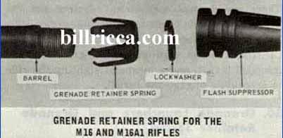

Original Armalite/Colt brochures show grenade launching with the M16. Same grenades as Korean war. There is a 5 or 6 star shaped spring that mounts behind the flash hider to secure the grenade when it was slipped over the muzzle. I used to have one in my stuff.
Yes, I'm aware of the star shaped clip mounted behind the flash hider. I just haven't seen anything on grenade launching with the ARs.

The AR 15 / M 16 can fire hand grenades with a projection adapter, signals star and parachute, and the large Energa AT types. No separate launcher is required. The standard flash hider is 22mm in diameter and all U.S. and NATO grenades fit. I was given a number of XM195 Grenade Cartridges, and had to compare them with M200 Blank rounds to see the difference. In the photo below the XM195 is on the left. It is shorter in the neck and overall length than the M200 Blank. The M200 Blank also has a knurled ring about 1/2" up around the case. My XM195s are headspamped "Winchester / .223 Rem", the M200 Blanks "LC / 88"
The spring attachment is not required to launch grenades / signals, but keeps the item in place in case you inadvertently point the muzzle down. I have added a photo of the U.S. M29 practice AT grenade with the 'rocket' fins per Bill Ricca's post above.
I was lucky to get plenty of the retaining springs back in the 1980's. This is a picture I used when I put them up on eBay back circa 2002. Nowadays I stay away from Anti Second Amendment eBay and sell these on my site.
https://www.milsurps.com/images/impo...0Ret2003-1.jpg
Actually it would be dangerous to launch a high explosive without the retaining spring. As Tom stated, it could fall off if the spring was not installed.
