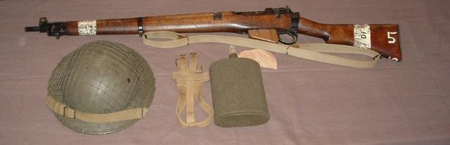

That was a timely picture by tlvaughn (click here) of his selection of No4 rifles which included a shot of an official No4 DP rifle, known to us in the UK Military as the RIFLE, DRILL PURPOSE, L59A1. I expect that some of the wild and untamed colonials and antipodeans among the forumers have been at their wits end trying to decipher what we unwashed Brits have been chuntering on about during our recent discussions about an Enfield rifle that is incapable of firing anything, but is still a rifle…….called ‘……..an L59!’ The L59 was a downgraded rifle converted to a non firing, totally inert rifle for training use with Cadets (and not only Cadets I should add). Incidentally, numerically this is the last Lee Enfield. While there were 6 L59A2's, that should be looked upon as a sample run. That fact makes a genuine L59 a cheap but important item in any collection of Lee Enfields. …...
The left side of a typical L59A1 Drill Rifle. Notice the distinct, wide white bands on the butt and fore-end/handguard. This particular rifle had a blunted/rounded tip DP marked bayonet fitted too. There doesn’t appear to be any official EMER reference to DP No4 bayonets in the relevant EMER SA&MG V150 but this bayonet bears a label with the distinct red ‘S’ for serviceable which is lined through and now reads ‘…to EMER DP spec’. On the basis that if it is DP, it cannot be truly serviceable.
http://photos.imageevent.com/badgerd.../L59%20001.jpg
(Click PIC to Enlarge)

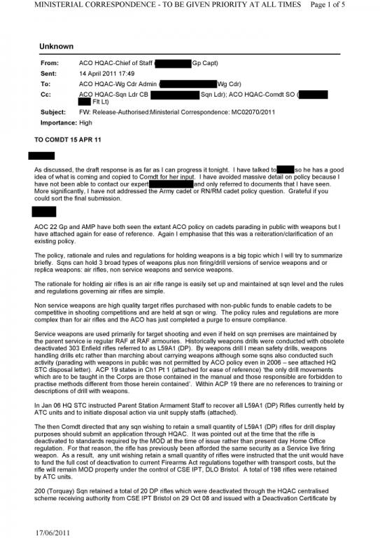

It looks like there are still some L59A1s in service, albeit, L59dand then deactivated to home office specs.
https://www.milsurps.com/images/impo...L59A1png-1.jpg
