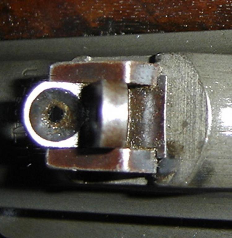

Does the barrel date 3-44 fall into the time frame? My understanding is the US&S receivers were delivered late 1943 and first quarter 1944.
Looks quite nice. Does it have any cast parts? Trigger, sear, or hammer?
Very nice indeed! Did you do good???
What are the markings in the sling well? Looks like an old cartouche under the smaller one.

QHMC's are know to have a circle around them. I have a couple with it and there have been a few COM's that also have that feature. Cartouche looks good to me.
Wtmr, you know a thing or two about UN-Quality's??
I haven't had time to tear it down yet. Front sight is EU marked. Stock has Q RMC in sling cutout. Rear flip sight is GE-Q. The seller said it was all Quality inside. Price was $2250 and I got it for $2000. Seller said he got it from a Greensboro NC policeman.
Who cares what you paid for it , they are like hens teeth. HOME RUN! Don`t let this one go, you won`t find another. You are a lucky dog
I would love to own it, Im just partial to type 1 barrel bands, I know type 2's are correct on carbines of this period, but my collection consists of all type 1's, though Id make an exception here..if I had my way, Id only collect type 1 stocked carbines! I only have 1!
The rear sight is 100 percent , the stock, every thing, Did he (the seller ) say any thing more on the policeman , how he came about it
I too wonder a bit about the barrel date as in March of 1944 QH was into the 4.78 range according to the March 15th testing program.
un-quality vrs. quality hardware numbers. Carbine of the month, newsletter #365. UN-QUALITY #4,458,855 also has an Inland barrel dated 3-44. It's serial number is only 1,195 away. So definitely close to known original.
Un-Quality #`s.4442350.underwood barrel 1-44 #,4462145 Inland barrel 2-44 #4433885 underwood barrel 11-43 #4434737 underwood barrel 1-44 all fall in the same range ,The barrel is right
Finally tore it down.
Bolt - EM-Q
Slide - DA-Q
Trigger Housing - Q-TX
Hammer - LT-Q
Mag Catch - EP-Q
Hand Guard - Q - RMC
Looks original to me..............:madsmile:
