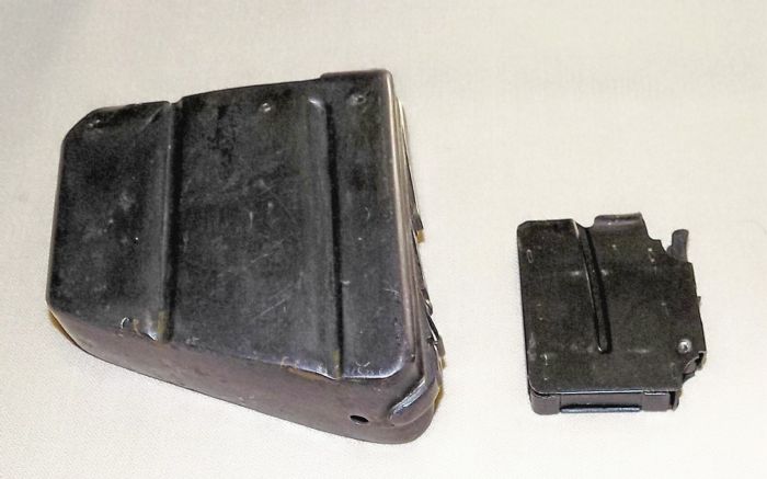

Dave, what about making the kits with a bog standard, cheap, readily available, off the shelf 5 or 10 round magazine fitted into a standard magazine case. This would be simplicity itself to make a small jig to accurately align the internal .22" magazine and retain it with an epoxy material. At least the buyers will have a magazine to get them started PLUS you'll be able to sell extra magazines to existing owners of No7 rifles - even if they've got an original, an extra useable magazine will be useful.
I think that this is the route being taken by the maker of the L1A1 rifle sub calibre kits who is in a similar boat. The big outer and smaller inner magazines are available but not the onterface adaptor. So just resin the inner into the outer. Similarly with your No7 project. The outer magazines are ten a penny, so are suitable inner magazines - so bond them together! That's just my idea

Modifying the magazine for 'upside down use' is not difficult.
A bit of cutting the tin-work and rotating the catch and job done.
A BSA Sportsman No7 Magazine, Vs a standard BSA Sportsman magazine.

Our local gun auction (every couple of months or so) has the BSA Sportsman 5 rifles at virtually every auction, I have bought many of them removed the magazine and left the rifle there and asked them to scrap them. I've then either modified the magazine (you need to turn it upside down and move the catch) or sell them as 'is' on ebay. Drop me a message and I'll give you more details.

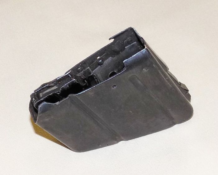

Sadly, we all have our problems, I'm still looking for a rifle to go with my magazine!
Attachment 135118Attachment 135119
