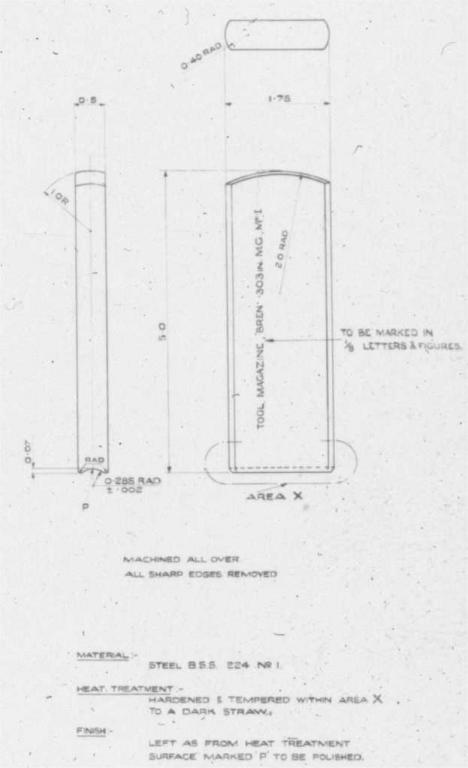

I have several different bren mags 3 of MA 42 that fit tight into the gun and feed fantastic
then I have 2 of JI that are a bit lose and miss feed 1 in 10
then I have a 7 of ones marked with a broad arrow a star and 4C that are very loose and let the bolt go under the round which results in a long dent on the round that did not get stripped off.
whats the best way to make these loose ones fit better? they need something done to the mag catch lug on the mag body. do I weld it or is there an easier solution? I have 9 mags to do
