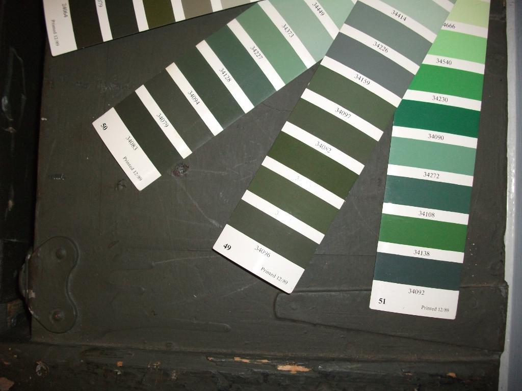

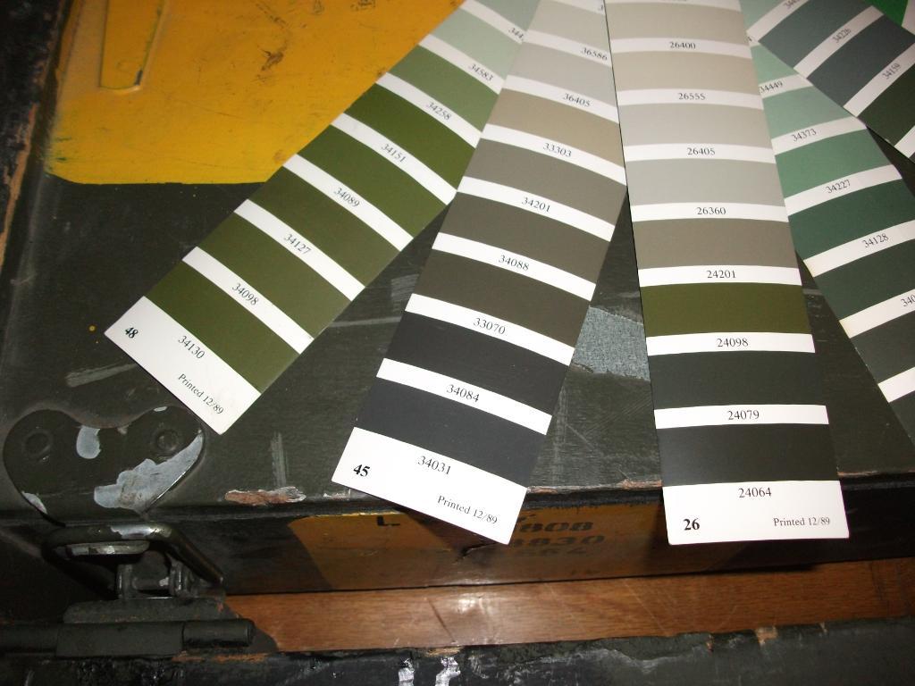

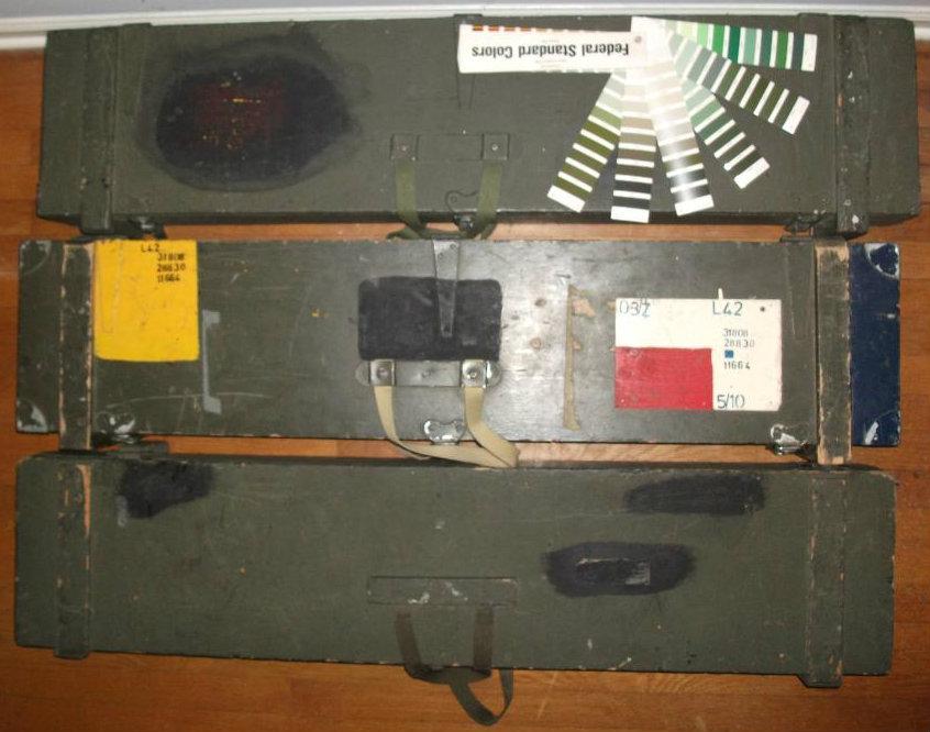

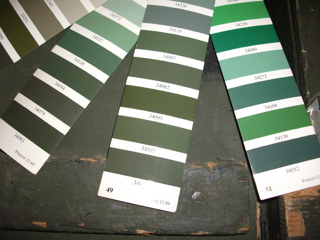

Having dramas with the photo hosting site, but here's some preliminary comparartive photos with an old Federal Standard selection:
https://www.milsurps.com/images/impo...048f0c6d-1.jpg
In certain conditions, FS 34079 seems a good match, but not at all angles:
https://www.milsurps.com/images/impo...c237f30b-1.jpg
34096 (the number is lost in the glare) seems better:
https://www.milsurps.com/images/impo...a4fa7f02-1.jpg
But on the "fancy" chest, the paint is less flat and matches the FS 2xxxx level of sheen better. In this case FS 24079 seems good:
https://www.milsurps.com/images/impo...0781e662-1.jpg
The last chest is more matte than the "fancy" example, so FS 34079 looks good:
https://www.milsurps.com/images/impo...3e63a221-1.jpg
I'm guessing that since the first chest is not only a little different in color but is also of non-standard construction in addition to being heavily used, the paint can also be considered "field expedient" or just a slightly different batch. Interesting how the higher level of sheen makes example two seem darker.
There's about 60 or 70 photos to crop and winnow out, but maybe this won't be alogether too late to be of use.
