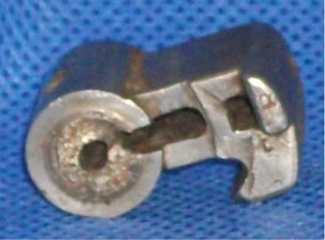

Two PINS, cap, fore-end that fit across the fore-end and mate up (? if you're VERY lucky that is.....) with the corresponding holes each side of the CAP, fore-end. They have little stepped flats on either end and these flats face inwards - to face each other. The BAND, upper sits across the flats and it is the band that holds the pins in place if they are loose. Clever eh!
These pins are also the same diameter as the 4BA screws and also the pin, axis trigger and sear and backsight axis pin. All done for simplification

Not a great shot, but the flats on the cross pins mentioned above may be seen.
If the holes don't line up it should be simple enough to sort.

So I'm not crazy on that, it does take luck! I worked on a No 4 Mk 2 fore-end last year and in putting a new cap on I couldn't figure out why the pins wouldn't go in. In the end I had to very slightly bow them both in the middle and then they popped right in. I thought I was going to go crazy trying to get those things in :lol:

Them's the ones......... Note the little flats, there for a purpose and must face each other. The upper band then retains the pins.
Ok so now I have to find some......bummer Ive never seen any for sale. I might just use some 4ba screws until I do....thanks
