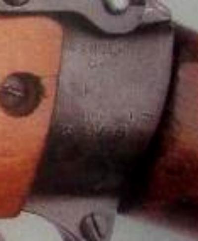

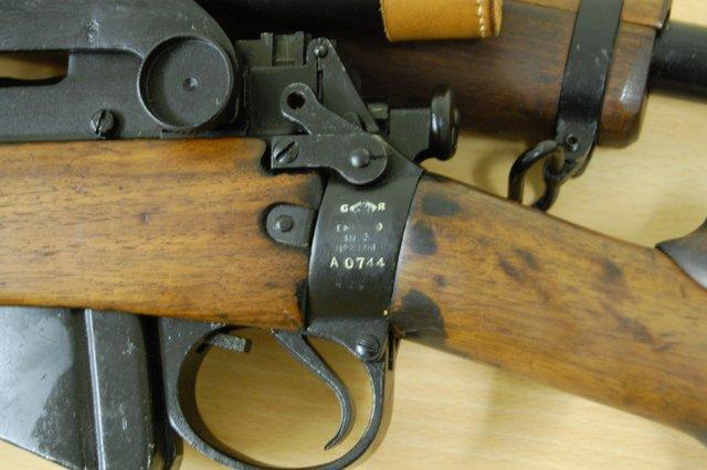

https://www.milsurps.com/images/impo...5355ab6f-1.jpgThis is the wrist of my trials T. The 1931 date and the FTR stamp is illustrated nicely.
Mmmmmmm. Just looking through the threads and noticed BigDukes two posts, #17 & #30. The serial number mentioned is catalogued as A23306, my rifle has been double struck and reads A23306. The woodwork also looks different, however it would appear to be the same rifle???????
Confused .com!
Comments please.
https://www.milsurps.com/images/impo...b88d14b5-1.jpg
https://www.milsurps.com/images/impo..._zpscfa7-1.jpg
A quick mild enhancement of the photo in bigduke6's Post #30. ETA: Maybe! P'bucket isn't cooperating again!
As far as your rifle being the same, it wouldn't be the first time one has been "restored" a bit. And if it is the same, it's probably a good thing as the forestock above is for a No.4 Mk.2.
Just had the old girl out and compared the front pad screws which are in the exact same position and the features just visible on the wrist band in the catalogue pic do correspond with the markings on my rifle. I think its fair to say it is the same rifle. I would be worried it was a dudd had I not purchased it from Fulton's of Bisley.
Certainly had a makeover since I last saw it (would say it was for the better), I know the scope can went missing at the time, cant remember the scope but IIRC was a bit worse for wear also, (not like the condition of the one pictured)
I was more interested in the Knock up L42 at the time, thats quite easy to spot as it had a hole in the butt socket (left side) shame really as someone at some time has carved up a No4T to produce a .......... I guess this may have been rebuilt back to a No4T since the auction, or even is now a L42 sporting the correct engraving etc ?

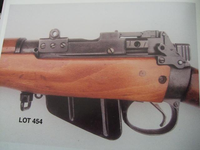

The bolt has the Canadian "C" with a broad arrow engraved and the case which is a converted Bren case has the same acceptance mark stamped on one end. ????
Bolt may of been fitted at any time, as for the box, there was no box in the auction (none in the description in the catalogue and none that I could see), it should of had the scope can this was in the catalogue correction sheet, but it had gone AWOL at the time of sale.
Description below,
Lot 454. A SCARSE .303 Cal. No4T bolt action Sniper Rifle. serial No A23306. Standard specifications. The action having fitted side mounts for the No32 scope. The strap marked Enfield No4 Mk1 T, the butt stock with correct cheek piece. Grade 2 plus. Brl.25 ins. NB If the scope can, can be found will be included.
Small strip of paper (corrections) in the catalogue, had the scope details etc,
Lot 454 Complete with its original scope marked - Tel. Stg. No32 Mk111 OS 2039 A,
AK&S No 28338 1945 In its original green painted steel case complete with tools.
The scope case never appeared it may of been found later? at the start of the bidding he said it hadn't been found.
I,m sure one of them yours or the L42 repro had the scope covers (which were or seemed original)
Hope this helps.
Thanks Bigduke, Interesting trail in the rifles history and I don't suppose i'll ever unravel its 82 year journey. All said and done someone has done a fine job of restoration and I can confirm the rifle shoots very well. The way I see it is as long as the markings on the wrist are authentic, which I believe they are then I'm a very lucky boy to have a no4 T rifle with a prefix letter "A" serial number, not many of them around whatever the condition.
Two things you mention, it shoots well and your happy, cant say more than that.
To be honest when I first saw it, I thought it may of gone for a lot cheaper than it did, and plus the fact I don't know my arse from my elbow when it comes to any of the sniper stuff, Just What I,ve learnt from the knowledgeable few here and a few books, the only thing that concerned me was the double strike of the T, I know Peter mentions it above regarding the serial numbers, but being a Enfield built rifle and the conversion being done there I'd of thought it would have been struck with a bit more care ? Just my take on it at the time.
There was another Trials rifle, but a standard No4 , that was a real nice example which I compared with yours, only other thing was a No1 MkV which I,ve a soft spot for, that was a excellent example ( best I,ve seen) but at the time my plastic was bent to the max and the daughter had not long arrived .........

A0744 was another.
https://www.milsurps.com/images/impo...tandard-24.jpg
