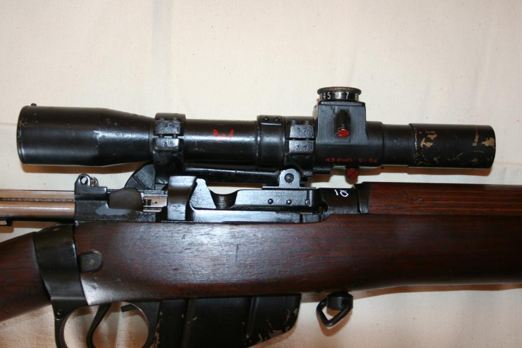

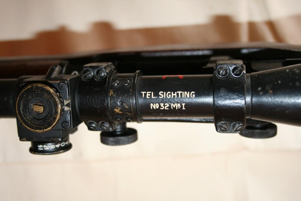

The seller sent me three photos none of which shows any detail to be conclusive. I can make out the rear site is missing but the pads look to be installed properly and dont appear to be staked. The scope is the only item that can be made out clearly, I have made an offer on this one so we will wait and see.

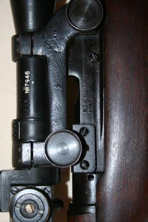

Last I knew 7946 lived in Australia!
I canna see the markings clearly, but it does look like a LB No.4(T) to me. The scope of course is British.
The markings that are legible, and far and few, do look like Long....... plus the model number is in the correct spot, and the wood sure looks like good Canadian walnut.
A decent shot of the receiver side with the serial number and markings would clinch it.......
