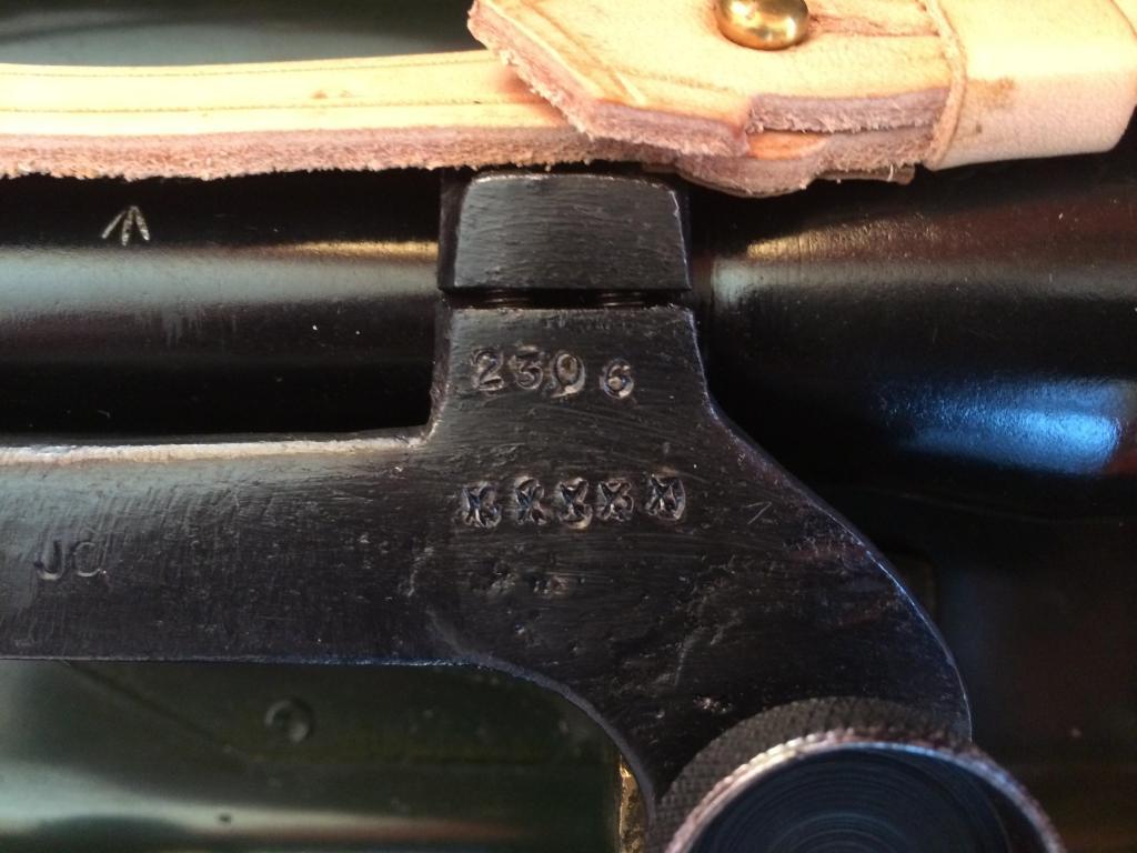

Personally I've never seen a bracket or photo of one renumbered by a few shallow chisel marks through the previous rifle number. Either it was "X"s all through, or peened out with a dull punch, or ground out, or some combination thereof. The goal being to make the previous number illegible.
Since the rifle has been painted at FTR why would the bracket not be also, and the scope for that matter? Not following SOPs from what I've read about them. Bare metal exposed by the stamps and no effort to rust-proof or dull it?
That bright shiny metal in the chisel marks and the matching number stamps also says "not done 50+ years ago" to me. I don't remember seeing oversize letters being used with smaller numbers either.
The case is nicely numbered to match the scope and the rifle, and the marking does closely match, almost, the original stenciled designation on the other side of the case. but of course the scope & rifle numbers didn't go on at that same time and place those markings, so how odd that they should so closely match!
Could it be that some enterprising soul thought it would be wise to copy the same style markings as near as possible?
There were 30 or 40 years ago lots of mismatching No4(T)s on the North American market; it wouldn't be surprising if some dealer was in the habit of "improving" things.
I could be wrong of course, but in what scenario would this kind of work have been done, if not in an FTR?
I do see indications of the "cancellation mark" on the original scope number, but why was it not also used on the original number on the bracket if it was done at the same time?
Could it have been a rifle that was FTR'd without a scope and bracket and that was the reason for the cancellation mark being used on one, and not the other?
I suppose it's possible some armourer somewhere, sometime did it this way, but it does not fit the pattern IMO.
I'm sure you've seen more than me but on all I've seen the old numbers were simply lined out and still readable.
Er........ what are we looking at? Surely, those you show are barred out and still readable aren't they? Just as they should be - and as we generally did them.
Surpmill,
Sorry I have to disagree. I have had several Lee's with scope mounts ie 4T/Enforcer and now an L42, all of which have either had two or more numbers stamped on the mounts.
It is also a "clear" data trail of the previous numbers, as armourers don't stamp x's on old numbers on the scope mounts they simply put a line through them.
Hope that clears that one up
Gil
I think the official directive (as Peter indicates) was to bar through, so as to make it clear that the number was no longer relevant, but not to obliterate it totally. Of course, we live in the real world & if the armourer just happened to have a 'X' letter stamp in his left hand & a hammer in his right.........!
........And of course, scopes/brackets were not just swapped over in British/Commonwealth service; many of the rifles that we see have been quite well travelled in the post-WW2 years. The possibilities for variations in marking under these circumstances are considerable. What I'm saying is that one might reasonably see different variations on 'genuine' refurbished/rematched rifles. I have seen serials obliterated with a punch, XXX'd out, as well as lined, & all on weapons I believed to be un-messed about with by civilian tinkering. Most were lined out.
ATB

Well I stand corrected on the bracket numbers! I'm wondering why it was thought desirable to be able to read the previous numbers? Not great psychology to issue a soldier a rifle that looks like it was assembled from used parts IMHO, but...
The numbering on the case still looks too much like someone being clever to me; but I'm willing to be proven wrong there too! ;)
I must admit I can see where you're coming from on that one Rob. It does look rather uniform & neat. But then again, I don't think anyone is ever going to be able to say categorically one way or the other (unless it HAS been faked & the faker comes clean - ha! ha!). I'm open minded on it, but if I were interested in buying the rifle it wouldn't be a serious minus for me.

Attachment 51671Attachment 51671Here is a pic of a sniper case with the same writing.It was a all matching legit FTR rifle.
Looks like it was off a Maltby rifle.
You are correct!A 1941 maltby.
Leaving the old number visible prevents theft and philandering. I have seen the rule in print re Canadian Forces guns, and I am sure it would have been the same for British service. If, for example, a receiver was re-used to repair a different rifle, the original number would have been barred out (but still legible) and the new number stamped. If a rifle is found with the serial obliterated or signs of tampering, then the rifle was to be backloaded to 3rd line for determination.
This prevented someone from playing musical chairs with equipment through exchange or outright theft.

https://www.milsurps.com/images/impo..._zps1c05-1.jpg
My 1931 trials T bracket, previous number is clearly X'd out. I can just make out 31030 but I think its safe to say the intention was to obliterate the numbers.
Thanks for that Steve, first one I've seen like that, and would have been a right clout several times to obliterate deeply seated numbers with those x's
