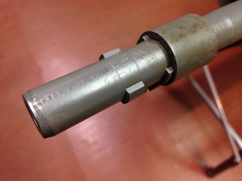

Gentlemen - Any useful information on the underside end of the barrel?

The BNP markings on the under side of the muzzle are just standard modern civvy proof marks showing it has been nitro proved in Birmingham (UK not Alabama).
