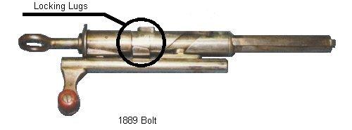

Crazy, second one of these to show up this month. You do not have a K11, you have a 1889/1900 short rifle made in 1905 which may or may not have been converted to K11 "standards". I would not recommend firing GP 11 in this rifle. The bolt has locking lugs in the rear and is weaker than the actual K11 which has the locking lugs toward the middle.

It should be safe for the GP-11 cartilage. The 1900 short rifle action was the 1896 model action not the 1889 (the 1896 based action is the one used for every Schmidt Rubin in GP-11 aka 7.5x55 Swiss). The locking lugs will be to the front of the bolt locking face as the only carbine the Swiss made that was not with the forward lugs was experimental ones that failed in the trials for 1893 carbine (hence why they adapted the 1893 Mannlicher). The conversion to the K1900/11 Carbine was specifically made so that carbine could shoot GP-11 so you will be good to go. Remember if it wasn't safe the Swiss didn't make it, they took every bit of pride in there work and the quality of the product being produced.
So many people get worked up over what is safe for a Swiss and what isn't, its pretty simple to figure it out. Here is a quick photo reference. If the lugs are like this, don't use GP-11 in it.
https://www.milsurps.com/images/impo...xsqk0bhw-1.jpg

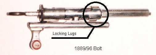

If the lugs are like this then it will be safe for GP-11.
https://www.milsurps.com/images/impo...ceuuypez-1.jpg
I haven't really spent any time around the 1900 carbines or the 00/11s. I was under the impression that they are made on the 1896 style action. I still stand by the above statement though, if the lugs are to the rear (first picture) I wouldn't put GP-11 through it, if they are forward more (second picture) it should be fine.
Disregard my foolishness as I must have been day dreaming. I rechecked and my lugs are at the front of the bolt.
