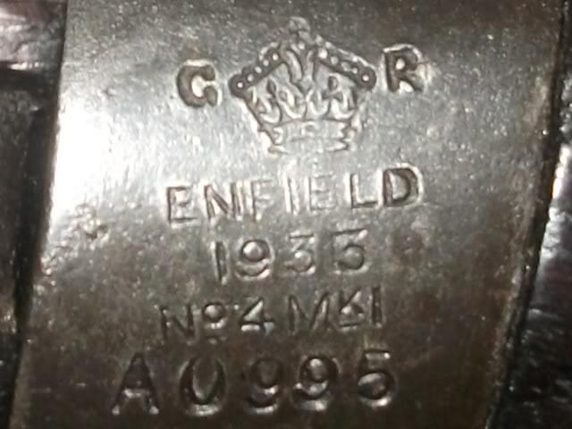

No 4 Mk I Trials Rifle, A0754(T)
As you say Martin, she's most definitely the real thing - & like most other Enfields she's well travelled. During her time she's picked up a fair few replacement parts, but it's all part of her story. Any Trials rifle is a nice find - I hope you have the enjoyment of owning her for many years to come.

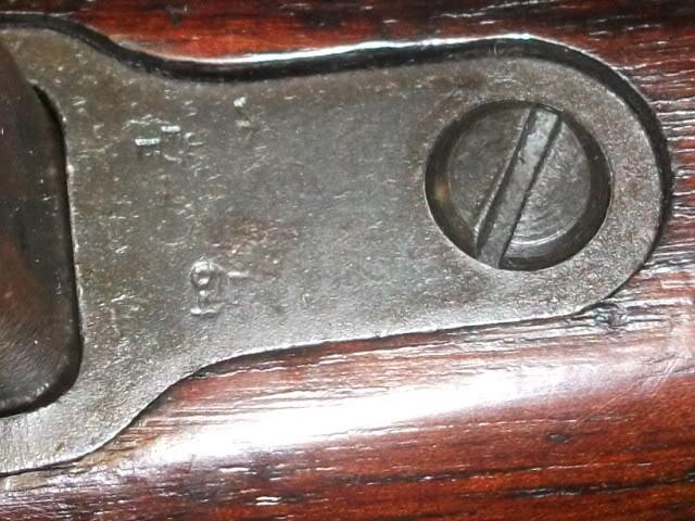

How about the trigger guard? Enfield marked? !933s and trigger guard loops don't often go together.
Curious about the "non-T" rear sight as well. Photo ot three of it's various faces would be good.
4 Attachment(s)
Here are the markings on the trigger guard, rear sight and bolt head.

I know Peter, but being a beech butt it can't be the original and the vast majority of the trials conversions got cheekrests later did they not?
Yes, but like you say, not all were fitted with cheek rests.

Congratulations on your find. The swivel under the upper guard is another Trials rifle feature not found on production No. 4 rifles. Given her age, she is not too bad. Trials body, matching serial numbered Trials 1930 dated barrel, proper and rare early wasp waisted MK. I foresight protector, rare upper swivel (stacking swivel I believe), MK. I button cocking piece, Enfield stamped bolt head. Don't worry about a sniper swivel in front of the magazine as that was a 1945 period add-on. Yours has the Enfield examiner's stamp on top of the front scope pad which shows that it was one of the first 1,403 No. 4 rifles converted to snipers by Enfield in 1941-1942 and not the 1942-1946 conversions by Holland and Holland, so it would NOT have has the "S51" stamp on the underside of the butt.
The likely explanation for the A suffix instead of prefix on the bolt handle is that non-standard rifles sometimes later had an "A" suffix mark applied AFTER the serial number to show that these parts were non-standard and were not interchangeable with normal service rifles.

Just curious, my period original Trials rifle's serial number is A1374 and it's dated 1931, where as the Op's rifle is dated 1935, four yeasr later, but the serial # A0754 is lower then mine. Why would that be? Ray

It's a reworked 1931. Sometimes you can see the old "1" under the "3", etc. Seems that most '31 rifles had the little loop on the forward part of the trigger guard, but '33s don't. Haven't seen enough of the other years to be sure but that loop was not cut on more than one later redo. Other changes affected the cocking piece/striker and rear sight.
https://www.milsurps.com/images/impo...stuff076-1.jpg
A '33 trigger guard. Look closely and you can see the remains of the loop.
https://www.milsurps.com/images/impo...stuff062-1.jpg
The "1" is still faintly visible just in front of RH "3".
Thanks, I see the shadow of the one now and that the "3" looks newer, Ray
