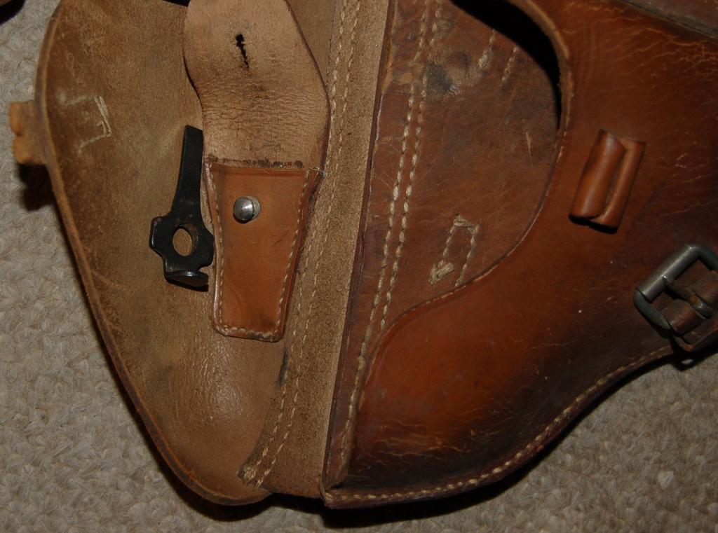

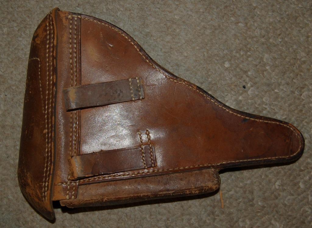

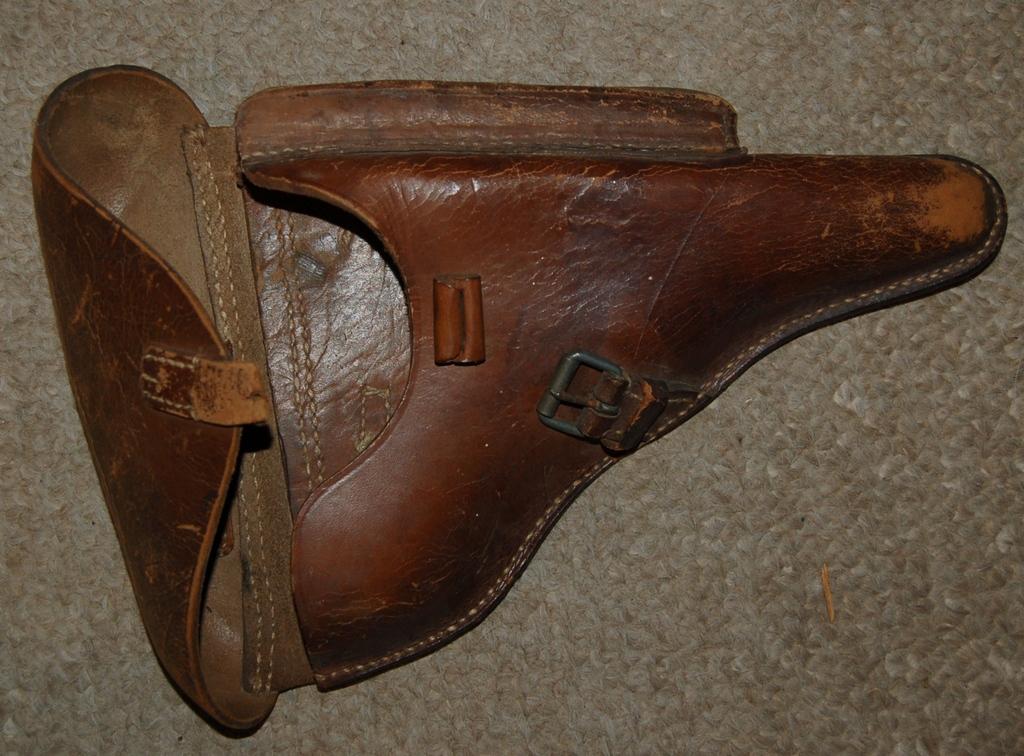

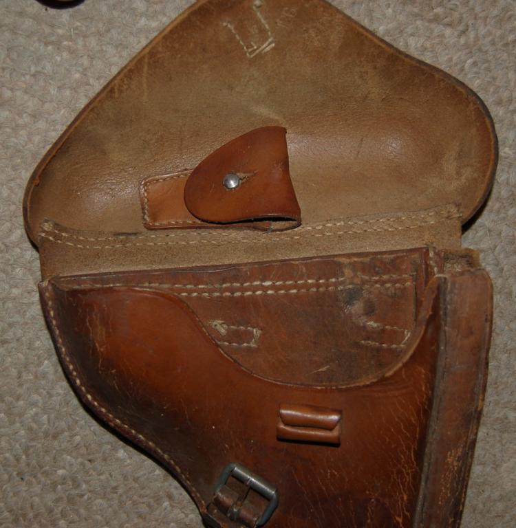

I picked up what I believe to be a WWI Luger holster the other day that has some damage. It is a little dried out and the closing strap is torn completely off at the last hole. I have photos posted in the "Other Military Service Pistols and Revolvers' thread.
Looking around the net, I found several sources that note the strap has been replaced on various holsters they are selling so it is done.
I'm not looking to sell this but to use it in my displays but I don't want to destroy it's collectability if it has any by repairing it. My personal preference would be repaired. I'd also like to treat the leather so it doesn't get worse. It is pliable for the most part.
One other area is the small loop next to the clasp. That is very close to tearing in half, any way to stabilize it?

Do not over oil the leather,,,
The worst mistake is to drench dried up leather in neatsfoot oil.
If the leather is stiff, drenching it will simply turn it to mush.
The trick is to use a lanolin based treatment,,,
And go slowly and sparsely with the applications.
One product I've used in the past is Dr. Jackson's Hide Rejuvenator.
Rub just a little bit on the leather,,,
Then wait a few days for it to soak in.
Then do another application,,,
repeat as many times as necessary.
Resist the temptation to flex the dry leather,,,
If you do that the fibers will break,,,
There's no repairing that.
I once restored an 1850's holster that was dry as a desert stone,,,
Honestly, it took about six weeks to rejuvenate the leather.
But when the hide rejuvenator finally permeated the fibers,,,
The leather became flexible again and the holster was restored.
As for sewing, do yourself a favor and learn to saddle stitch with two needles,,,
And save every piece of the original leather parts,,,
That's for the collectors who want it all.
I hope this helps.
