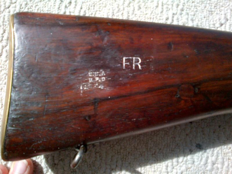

With the FR (Factory Repair IIRC) on the stock, inevitably something was changed that needed more than a simple field repair. Have you determined what was repaired?
I have a 1944 Savage/Stevens with FR on the butt stock (with Inspector's initials and the date 12 - 44 stamped underneath the initials) -- it now sports a American walnut stock (so evidently the birch original was replaced) and a replaced bolt (from a 1943 Savage/Stevens). Probably a good assumption it was post-D-Day rifle that got whacked in battle.

Note the repair in lower right corner of the pic -- seems to indicate this butt stock came off another rifle that had been damaged. Just as Capt. Laidler tells us: Armourers just grabbed the next good (used) part in the bin, fitted it to the rifle being repaired, and moved on to the next one.
Question: did any of the factories set up a remote facility in France after the D-Day invasion to do "Factory Repair" on the continental side of the channel, or was everything shipped back to the UK for repairs?

That rifle looks like it's had a rather large ding routed out and replaced with an inletted piece of wood. Yep, patched a few like that, especially Brens!
