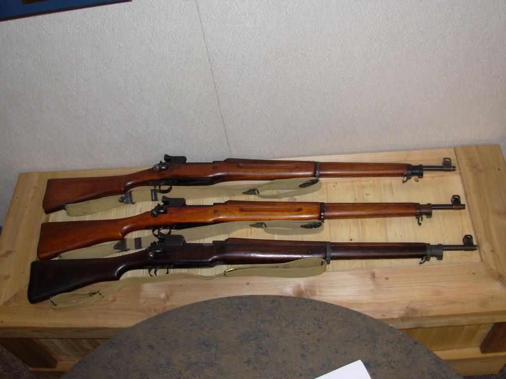

not to belabor a point , but it sometimes crosses my mind that those who use incorrect nomenclature dont actually realize why it is so important to the discussions , this one startsed with NO3 mkI - here is what a no3 mkI actually looks likt , the dark one here made by eddystone in the USA ................ nothing like a no1 mkIII/III* brit and ausie [yours] or a no1 mk3 [india]
https://www.milsurps.com/images/impo...8f43a2fd-1.jpg
