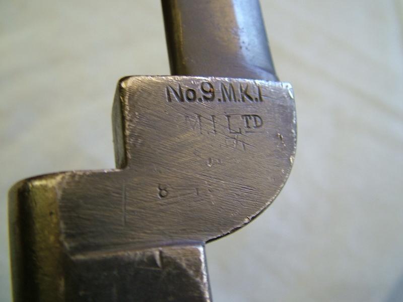

The Italians made one as well, but these are very rare and hard to come by. it has a much longer blade from an 1891 I think, there is also another Pakistani one made before the POF stamp, so these would have been made just after the partition
https://www.milsurps.com/images/impo...20MILJPG-1.jpg
Was that Military Industries Ltd? They were buying up quantities of Bedford trucks and spare parts from UK Ordnance stockpiles during the drawdown from the Far East
Peter same company they made 19807's in WWII as well, In fact it was designated as unknown till I linked the 07 and No9, it was an Indian production facility until the partition and then became Pakistani and then got renamed POF, not a common one at all, the Italian was the only one I know of that I dotn have other than trials etc, and I have a lot of them as repros from a guy in the UK who made some interesting replica's
