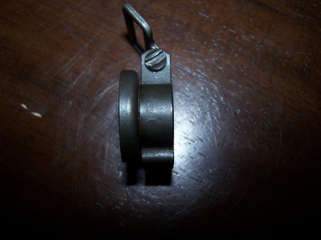

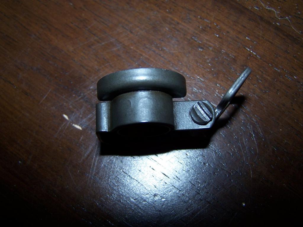

Broken original type one band vs replacement. Legit?
In my effort to replace my #2 carbines' broken barrel band I purchased a replacement represented as original. Broken original band is on the left. I suspect I may be sending the replacement back for a refund. I appreciate experts eyes on and opinions. What do you guys think and why?
Thanks. <0
I can add more pics but from what I can see in this one they may not be needed.

An example of a Laser Cut edge.
I thought that it may be helpful to this discussion to post a few example pictures to illustrate what a laser cut edge looks like. The best way to understand how the laser cutting works is to think of the laser beam as a miniature yet very powerful gas cutting torch controlled by a computer. You will see from my pictures the tiny lines running at tangents to the edge of the metal caused by the laser beam as it moves along the metal. Occasionally "Fakers" may try to remove these marks by grinding/linishing off but more often than not they seem to be left on, for the World to see.
