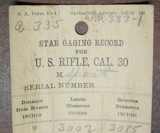

* There's no star-gauged mark on the crown of the barrel.

Hmmm. Wolf, you're sure you're looking in the right spot for a SG barrel - 6 o'clock position on the muzzle crown?
I told the gentleman over the phone specifically where to look for the star-gauged marking. He did not see one. It may have worn off, or as has been suggested, simply been lightly marked to begin with. Thanks a ton for all the info here, especially confirmation that it is indeed a 1903 Sporter. What do you-all think of the $2500 price?

I checked my data base and found that it was sold as an NRA Sporter. NRA Sporting rifles didn't have the bomb and NRA on the triggerguard, only the pre-WWI NRA rifles had that. He might not be able to see the star gauge mark as most were VERY lightly stamped on the muzzle. It may have a replacement bolt or the number was polished off the bolt. Ask what the bolt is stamped. Should be an N.S. bolt or maybe a WL 3 bolt.

Mine's not muzzle-marked either...
Just FYI.... I have a late-1929 SRS-papered NRA Sporter and the muzzle is not star guage-marked...However, when taken out of the stock, there is a star guage letter & number sequence underneath that yours should have, as well.....Mine's "B" over "3417"...
Brophy goes into detail on this...

Re: Springfield 1903 NRA Sporter Inquiry- Star Gauged Number!
Well, I took the plunge and bought it for $2500! I got my greedy little hands on it today, and immediately inspected it for a star-gauge mark on the barrel crown... none there. So, I CAREFULLY removed the stock (Ed B. said he'd kill me if I damaged any screws or the wood) and I found a star-gauged number on the bottom side of the barrel:
I
1659
Ed says this is an unusual star-gauged number. Anyone out there with additional thoughts/comments on the rifle would be greatly appreciated!
