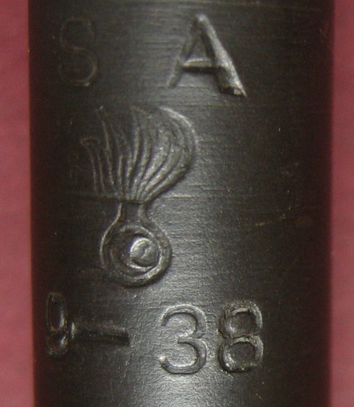

Each barrel is 12 years apart from the subject barrel. Flaming bomb is different on all three but the subject barrel is quite a bit different.
Oh, I just found this barrel in Brophy's book. Flaming bomb matches the 1942 barrel.

The flaming bomb on the barrel doesn't look right, here is an example.

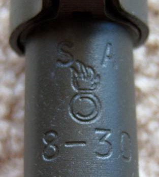

The 8 on the barrel in question looks like you were taught to make an 8 in the 1st or 2nd grade with a single stroke, while an original Springfield 8 looks like you were taught in mechanical drawing with one flattened 0 stacked on another flattened 0.

This is what it should look like.
