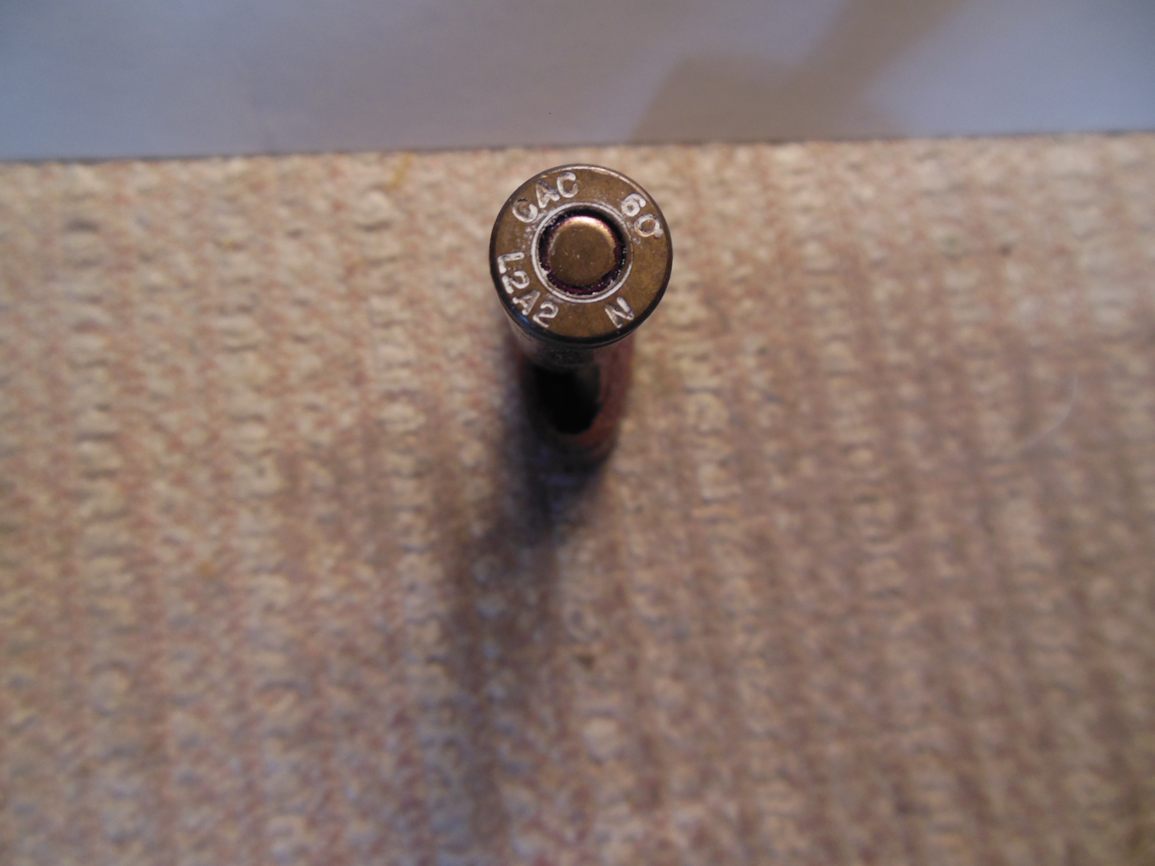

early New Zealand 7,62 head stamp
Do not know if this is common or not, but found a early 1960 New Zealand head stamp - how this is correct ?

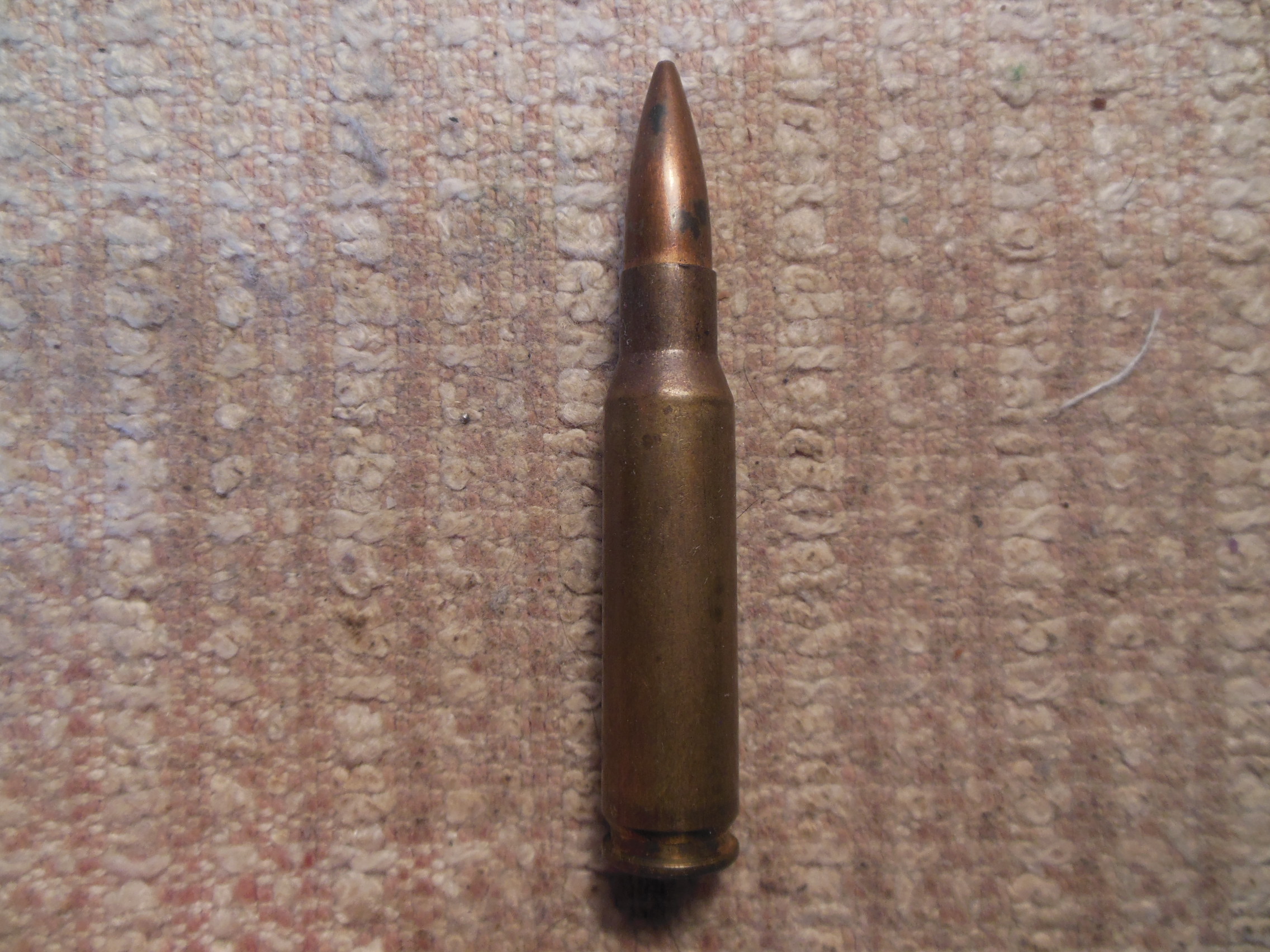

Also in response to the black primers: I have some US F A 49 AP 30 cal with a black primer.
In 1949 US Ordnance started testing non corrosive primers and used a black color primerAttachment 128674Attachment 128675

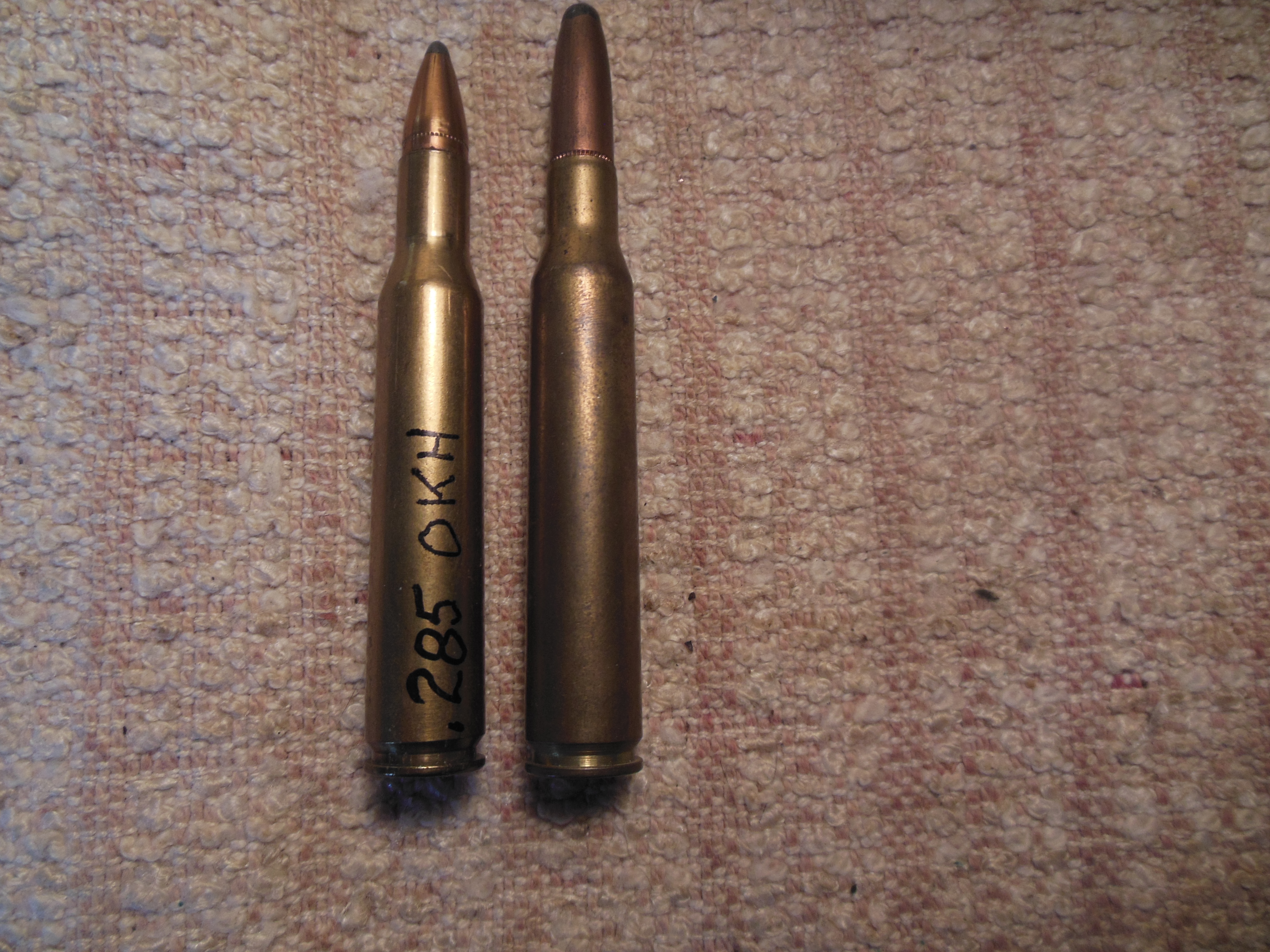

more wildcats the 285 OKH
the 17 Flintstone Super Eyebunger or Fred Flintstone can fire a 25 gr bullet at 4500 fps which can also punch through a 1/4 metal plate. the manufactures (Ruger was one) and custom barrel makers always had problems with 17 cal (and under) barrels. I have a 17/222 wildcat cartridge which has stood the test of time for the past 40 years. I understand the 17/223 wildcat is still popular.
My photo shows a 285 OKH from the well know group of O'Neil, Keith and Hopkins and has been around for awhile. Early developments use a flash tube inside the cartridge case extending from the primer,Attachment 128704 plus a duplex powder charge. In the duplex load a fine powder was used in the rear half and a coarse powder at the front, some loadings used three different types of powder with the flash tube. With the normal loading it appears the 285 OKH is not really any better than the standard factory 280 Remington cartridge

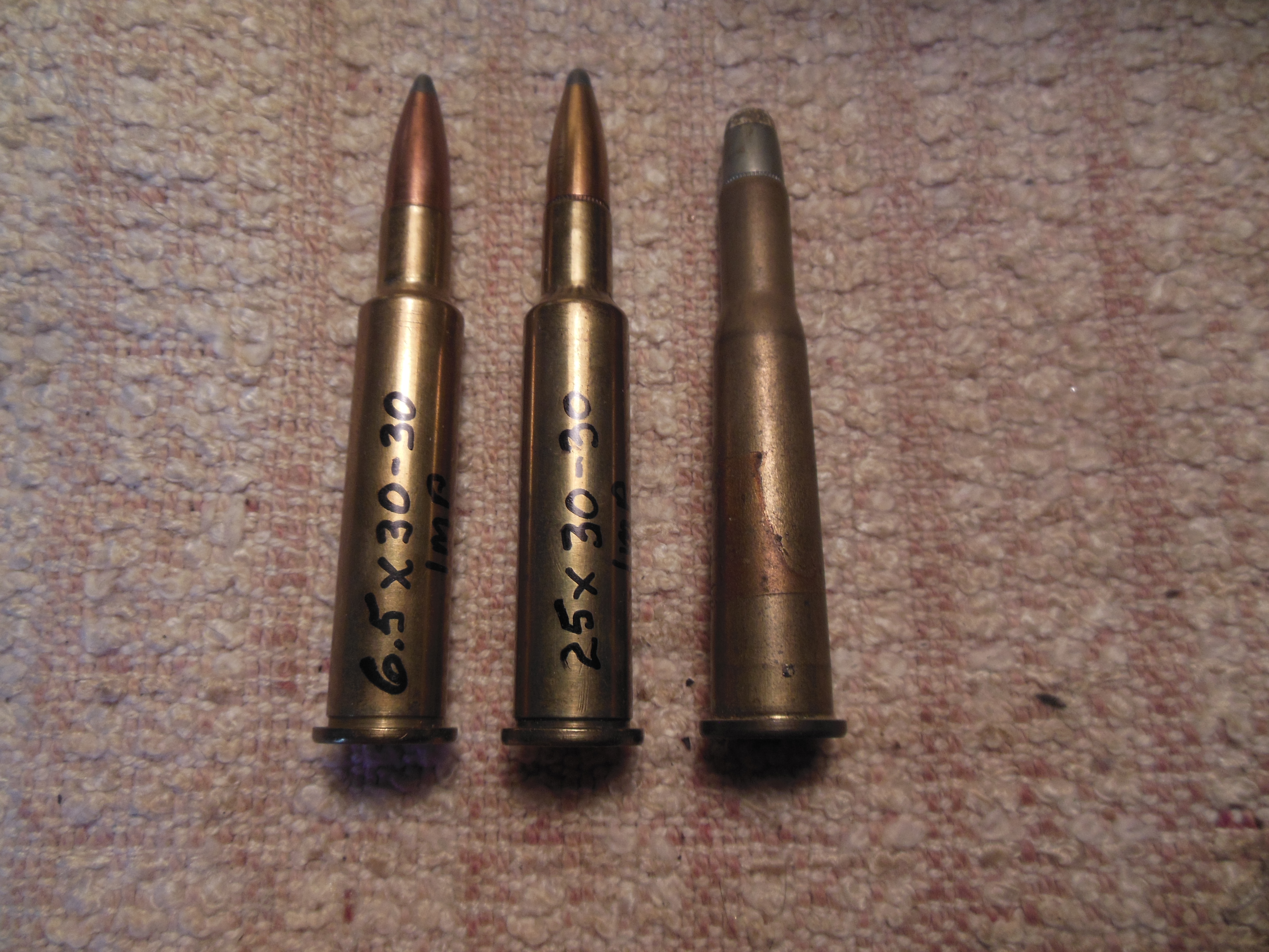

2 Attachment(s)
more wildcats of interest
The 7-08 Remington (308 necked down to 7mm) was really a military development dating back to the early 1950 period. At this time the FN Factory in Belgium took the US T-65 cartridge case which was 49mm in length (at this time) and necked it down to use the 7mm Mauser S12 bullet. This cartridge fired a 140 bullet at 2750 fps and was called the 7mm Liviano and sold to Venezuela with 5000 new FN FAL rifles in this caliber in 1954. When Remington introduced the 7mm-08 in 1980 it fired a 140gr bullet at 2860 fps -
The 30-30 wildcats have been around since the 1940's or even before. The two wildcats in my photos are 6,5x30-30 Bullberry and 25x30-30 (many others like the 257JDJ & Imp)
These were very well liked for hunting with the Thompson-Center single shot pistol - favorite was the 14 inch barrel.
Remington made the 30-30 into a rimless cartridge called the 30 Remington for pump and autoloaders
photos show the 7x49 Liviano and 6,5x30-30 & 25x 30-30 wildcatsAttachment 128712Attachment 128713

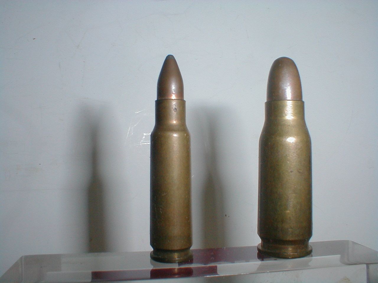

smaller wildcat cartridges
my first photo shows both the 22 Hornet and the 22 K-Hornet developed by Lysle Kilbourn in 1940. Kilbourn opened the chamber making an improved version which is still in use today.
The 22 K-Hornet will fire a 35gr bullet at 3000 fps and a 50gr bullet at 2540 fps
My second photo shows a 5,56x33mm shortened case for use in smaller weapons, Some years ago IMI developed a short 5,56mm cartridge with a case length of 22.9mm and total overall of 30,15mm which fired a 46gr bullet at 1902 fps in modified UZI machine pistols. This cartridge is also known as the 223 Urban Cartridge, it is unknown if still in limited service.
India also adopted a new 5,56x33mm cartridge in the past few years too.
The other short cartridge in the second photo is the 30 Cal Kurtz which was developed by a private company to convert the M1 carbine. This also required a longer barrel and modifications to the carbine. The cartridge used 308 case cut down
and sized to use a 30 caliber bullet of 110 grs. It was not very popular and soon disappearedAttachment 128770Attachment 128771

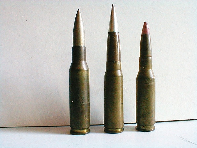

1 Attachment(s)

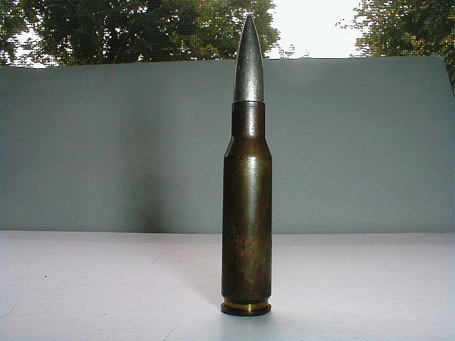

Cartridges developed during the pre NATO 7,62mm period
I have a photo of three early cartridges that were tested before the 7,62x51mm was adopted.
On the left is one of my favorites, the 7x49mm Liviano, it originated from the FN factory in Belgium using an early US FATIEL 49mm case necked down to use the 7mm Mauser S12 bullet
with a velocity of 2750fps with a 140gr bullet. FN in Belgium sold 5000 FN FAL rifles in 1954 to Venezuela chambering this cartridge. Still in service until the early 1960's.
Second cartridge is the 7,92x40mm CETME from Spain for use in the German designed CETME rifle. It fired a 105gr aluminum core bullet at 2690fps. The aluminum core bullet could not be used as a military cartridge. The CETME used a reduced 7,62x51 loading until a stronger action was developed to use the NATO cartridge.
Last cartridge is also a favorite of mine, the 280/30 cartridge developed during the early post war period. It fired a 139gr bullet at 2500fps and would still make an excellent cartridge todayAttachment 128896

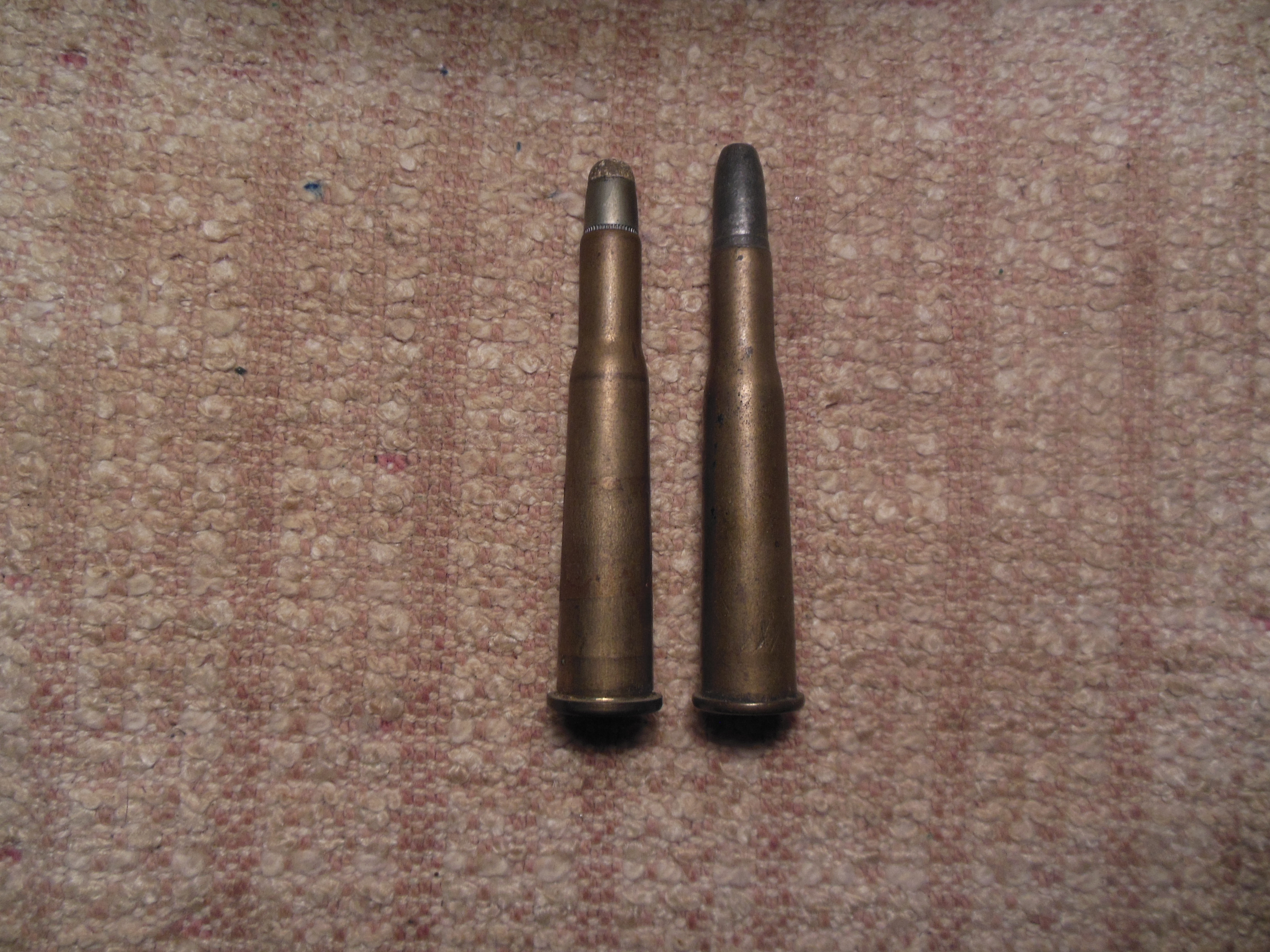

2 Attachment(s)

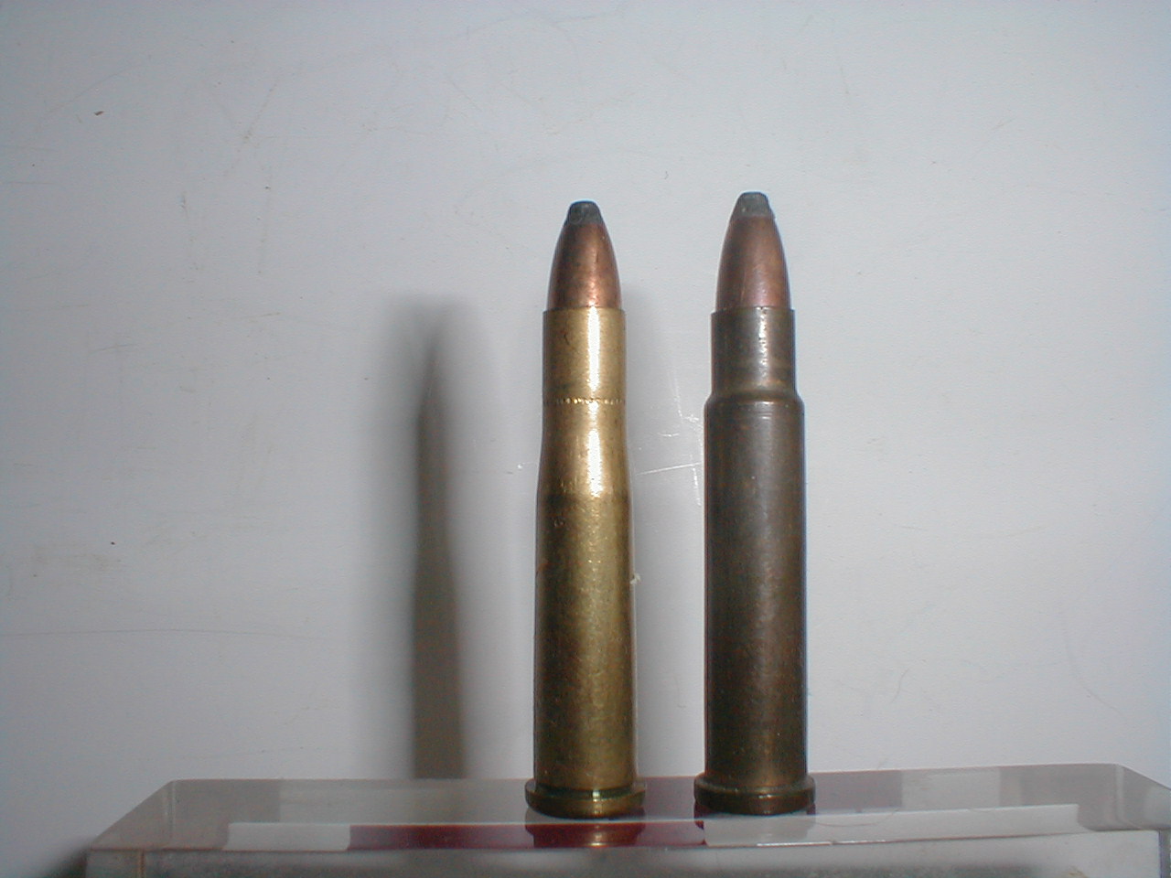

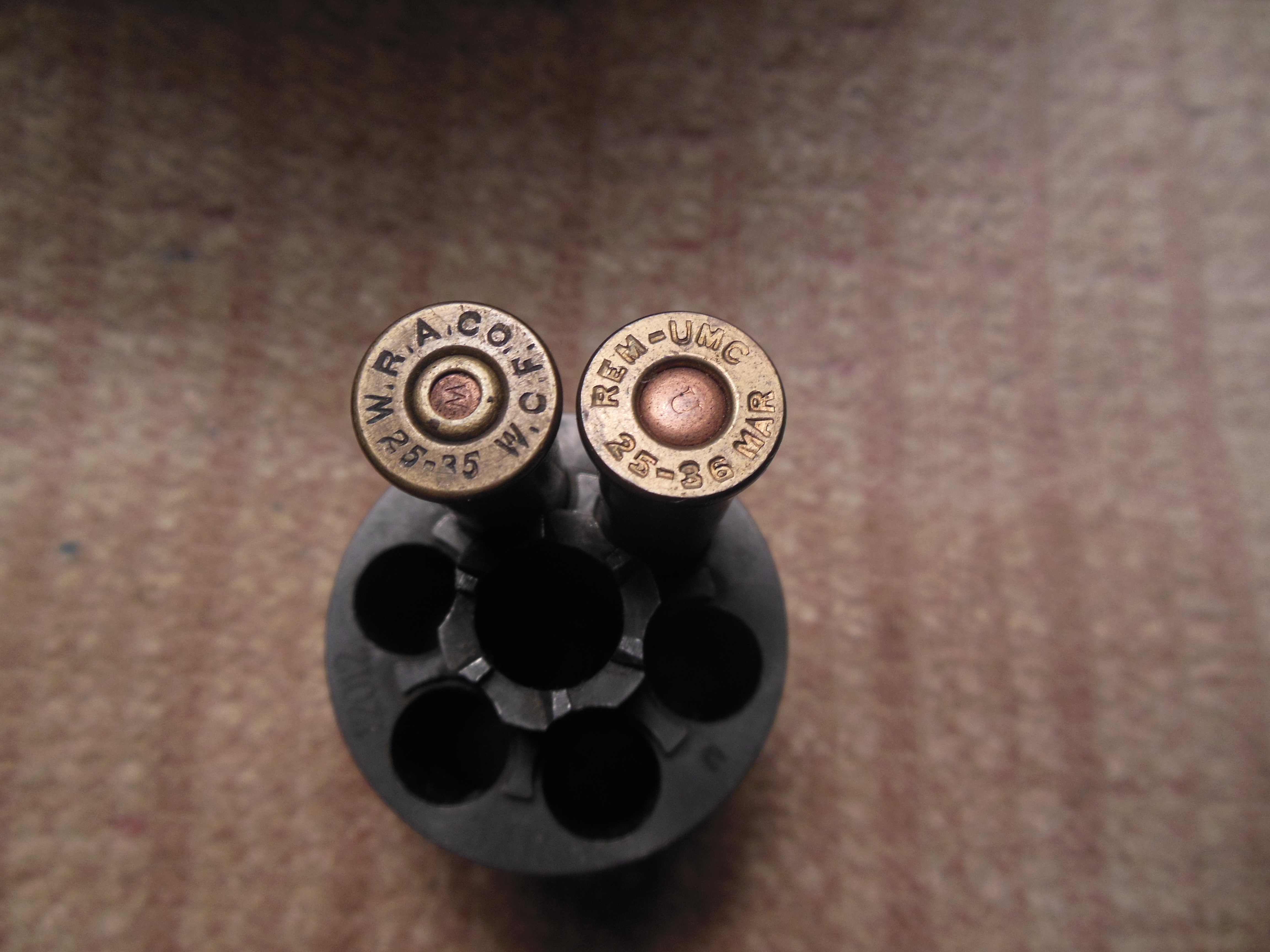

Winchester 25-35 and Marlin 25-36 cartridges
Both the Winchester 25-35 and the Marlin 25-36 were introduced in 1895 chambered in the Winchester 1894 and the Marlin 1893 lever actions. These cartridges were not quite the same, with the Marlin 25-36 being a little longer with a larger rim diameter than the 25-35 Winchester. The Winchester 25-35 could be fired in the Marlin 1893 but the Marlin 25-36 could not be chambered in the Winchester.
During the mid 1920's Marlin discontinue production of the 25-36 cartridge and hunters just used the 25-35 WCF in both rifles.
Note the Winchester Protected primer with the small w on the 25-35 cartridge. The outer cup was intended to lessen the chance of ignition in the magazine tube by recoil. Winchester used the protected primer starting in 1926 with the 25-35 and 30-30. Attachment 129005Attachment 129006
