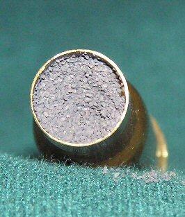

First if you break down one of the drawn brass LOC cartridges you will find loose fiber fairly densely packed. Call it a wad, call it filler, but it is about 3 grains as specified by Double D. As you say, they pretty much knew what was what by the time they adopted the drawn case. However it is worth noting that during the MH frontline service the foil cartridge remained that standard as it was produced well into the 20th Century.
What is being prevented is not the expansion of the charge upon ignition, but holding it in place until ignition and prevention of a "coal dust" effect, while also ensuring there is no obstruction at the neck. The more solid the mass, the more likely an obstruction will occur. Keep in mind that the filler that was used in part resulted from the change from the foil to the semi-ballonhead drawn case, which had a much larger capacity....very similar to the reformed CBC brass used by many. This same problem was also addressed by using a paper liner, which reduced capacity....but is problematic for reloaders. The solidhead brass sold today is less in capacity so the filler is that much less of an issue and a number of folks shoot the rounds with the airspace to no ill effect.
One major consideration when comparing BP cartridge technique is that the MH round is a much more severe bottleneck than others of the era, so much of common practice has to be reconsidered. Since I primarily use reformed CBC brass, I prefer to load to the MK I drawn brass standard as shown below:
https://www.milsurps.com/images/impo...4b1f145_-1.png
Patrick,
The issue we run into is that the LoC charge of 85 grains in modern solid head cases doesn't fill the case to the neck. In fact it just comes to the bottom of the shoulder in the solid head cases. It takes 95 grains of Fg to fill to the bottom of the neck in the solid head cases.
In the CBC semi balloon head cases it takes a 109 grains of powder to reach the neck. 85 grains in these cases are way below the shoulder.
We can only load card wads and wax wads to the bottom of the neck, this leaves a large airspace between neck wad and powder chamber. One school of thought is you shouldn't have air space in black powder cartridges.
Cards and wax wads work just fine in the neck, what do you use in the body of the case below the neck?
The one LoC load you mentioned had a cotton wool wad. I have pulled some of these LoC loads down and none of the cotton wads were 1/10 in thick, all were thicker, closer to 1/4 inch thick and compressed. One thing I noticed with the loads I pulled downs was that beeswax wad was often melted and had soaked into the cotton. Those loads had to get very hot to do that. The cotton was put in the case to prevent the melted bees wax from contaminating the powder in the hot Saharan sun. Greener mentions this in one of his books.
The paper liner was not put in to reduce the case capacity. The literature is very clear on that. The paper liner was to prevent corrosive action between the brass case and the powder. All the paper liners I have seen are tissue paper and do not serve as filler.
In order to address the airspace issue in modern case we turn to filler.
We can't use hard cards or below the neck because the powder chamber is larger than the neck. The only thing we can use is fiber and foam fillers. There is ample evidence that in the literature that filler were used in commercial ammunition. Eley and Kynoch used them extensively during the transition from Blackpowder Express to Nitro powders. Modern day Kynoch uses foam as a filler in their commercially marked ammunition.
Now to address your one comment regarding “fluffy” fillers. We aren’t using a little fluffy tuft of kapok to hold powder in place such as target shooter do with there light loads. We are using the fiber filler to fill air space. We are compressing as much filler as we can get in the case to fill the airspace over the powder.
Bottom, line we aren’t trying to duplicate LoC loads. We are trying to improve on that and we are quite successful at it.

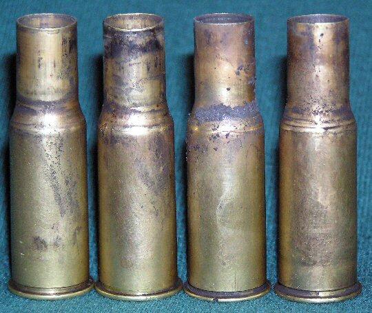

Correct, no fluffy filling, no ringing. Our fillers go below the neck over the powder down in the powder chamber.
No, I don't believe the cotton wool was put in the the case and then it was necked. It's very simple matter to put a cotton ball or piece of dacron or kapok in the Martini case by pushing it down with a wooden dowel.
Felt wads, stacks of card wads, grease cookies all work good in the neck itself. I have used all and they all work.
I have not pulled, or found any of the carbine rounds. so I can not offer any first hand knowledge on them.
I know some have tried various tubing, paper, and even copper tubing with less than satisfactory results. Just thinking about them worries me. And some of my worries have been founded by shooting results reported by others. The copper tubing was put in the 24 guage CBC shotgun case before the case was necked and formed to make the 45 cal. neck.
One of fellows on British militaria reported using copper tubing and after shooting finding the tubing sticking out of the neck of case.
You need a substantial amount of paper to reduce the powder space. The worry with this paper and cardboard tubing is where do they go when the cartridge is fired. Do they stay in the case, go down range or get stuck in the bore. You must check the case every shot and see if the wad is still there. You cannot miss a case...that might be the on that the paper or cardboard stays in the bore.
In the CBC shot gun case you could use water glas and put in a shotgun head wad. This is a standard practice in the old days. The hardest part of this is finding 24 guage head wads to fit the CBC case.
John, mentions using 50/50 Cream of Wheat and BP. I have used this technique. It works. I used it with Triple 7 as well as black powder. The use with Cow or any filler with Triple 7 is strongly not recommended.
When used with 2F Goex the CoW worked just fine. With any other grade of of black powder and 2Fg Swiss, when poured in the case the CoW and BP separated out from each other. This is not conducive to consistancy and was visable on the target.
Others have tried the nitrated paper with good results. But the reports were that the limited amount of reduction wasn't worth the effort.

I have also used the granular solids and in the bottle neck Martini cases they tend to slug up and stretch case necks.
https://www.milsurps.com/images/impo...tandard-54.jpg
The other thing is the amount filler needed to fill the case. The medium sized 45/70 case, even with reduced loads doesn’t use the quantity of fillers these big British cases do. The NfB loads use so much granular solids that most of it didn’t leave the barrel. Puff Lon was the worst. After firing, my cases and action covered in the stuff.
https://www.milsurps.com/images/impo...tandard-55.jpg
These two issues made me pass the on granular solids in the Martini case and stick to fiber fillers.
