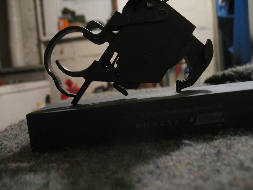

    Do you do any trigger work on your rifles? I have a spare trigger group that I tuned up, and completely got rid of the "creep" as well as lightening the pull. Whenever I go to the range I take it with me and install it on whatever I'm shooting that day. That way I can keep the rest of my rifles with un-messed with triggers. What you said about your FGs, is what makes Garandicon collecting a little little different than collecting in general, IMO. My favorite FG, actually a Rack grade, I picked up at NS the same way. Soaked in cosmolineicon, had all the dents and dings--and it's my favorite shooter. All the imperfections are part of the rifles history.

    Charlie59 - I have just gotten my M1icon from the CMPicon and your comment about the spare trigger group really interests me. Where do you recommend I look for the trigger group; and what did you do to tune it up? I would like to get rid of all that creep and lighten the trigger pull too.

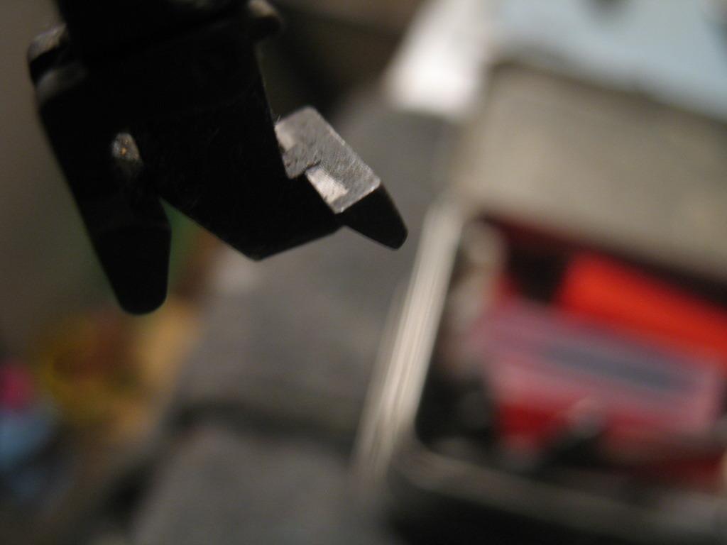

    I needed a trigger group to make a rifle all correct, so I got one at a gunshow, and ended up with a spare. If you are only going to have one Garand, it might not make financial sense to have a spare. I have several rifles I like to shoot, and don't want to alter them, so I use the one group with whatever particular rifle I take to the range. Here are a couple pics. First off, many rifles shoot fine with the trigger group they come with. But, some of mine have excessive "creep", so by honing them I not only get rid of that, I lighten the pull, too. Some guys also polish the sear, to a mirror like finish. I have had good enough results using a fine stone, and just go back and forth, until I get a trigger pull I like. Just be sure your stone only touches the spurs on the hammer, and the rear of the housing-like in my pic. The other pic shows how the sear wears from the hammer spurs. You might want to check around, I'm sure others do trigger jobs slightly different than I do.
