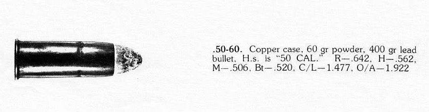

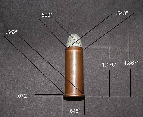

    Ideally, of course, it is preferable to duplicate the .50-60 Peabody cartridge as closely as possible, using cut-down .50-70 cases. Cartridge dimensions weren't quite as precise and invariable back in those days, so there are some slight dimensional differences between original cartridges made by different manufacturers. Here is a photograph of one original .50-60 cartridge, with dimensions marked, and also a scan of the specifications of another example -

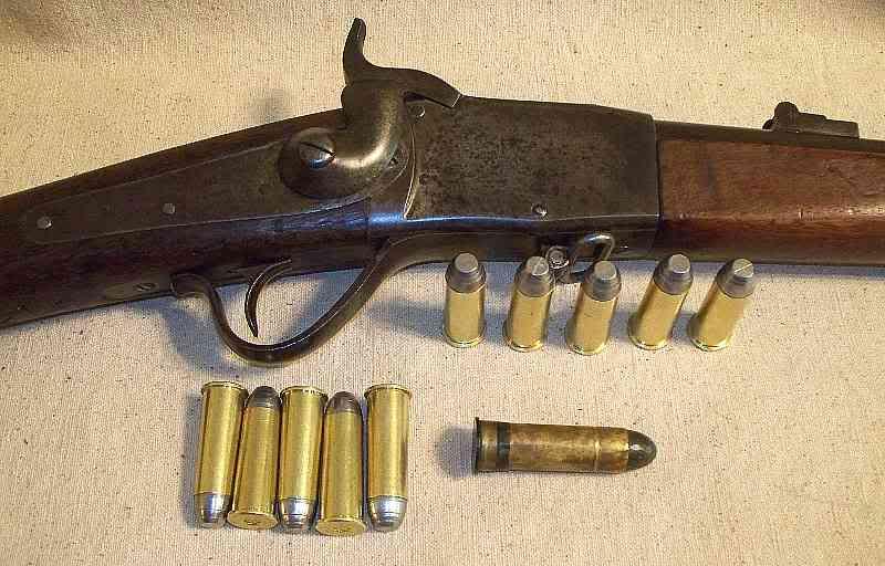

    My rifle, with some of my ".50-60 Centerfire" loads, in shortened .50-70 cases, loaded using .50-70 dies -
