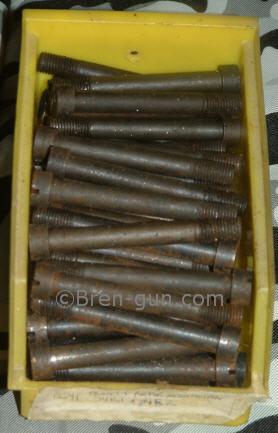

    Mk2 grips and bolts are NLA – or No Longer Available, certainly in the UKicon.
    63 MK2 bolts in stock :-)

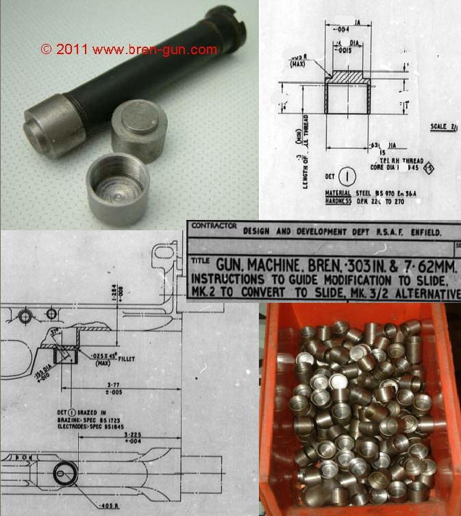

    Ah...., it's not the bolts that aren't readily available, but the grips Kev. It comes down to what's easiest for the builder. To make wood Mk2 bolt inserts and glue into the Mk1 grips or machine down Mk1 bolts to fit the Mk2 butt slides........
    But it does mean that a needy owner has a couple of alternative routes to take
    My appologies Peter I could have sworn you wrote - "Mk2 grips and bolts are NLA – or No Longer Available, certainly in the UKicon." ......I must be going dyslexic
    Anyhow there is also the officialy sanctioned way of overcoming this problem which you mentioned earlier for the L4.
    The drawing states it is also for 303 Brens.
    ATB KG

    I did indeed say that KG! 10/10 for observation. BUT they weren't available where we went - nor were Mk2 grips either! The bolts WERE readily available from a commercial fastening suppliers in length, finish and diameter. But, alas, not in BSF thread which would have entailed getting overlength, cutting and rethreading to suit! It all goes to help future budding LMG owners and builders come to a decision that suits them in the spirit of learning and the true meaning of the forum
