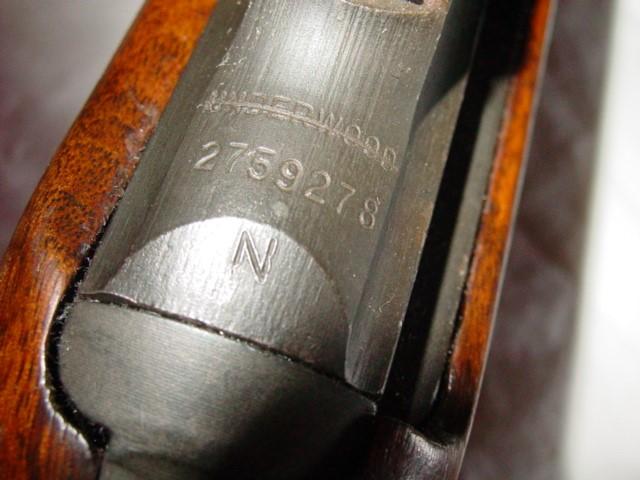

    Hello down in Nigeria Bob,
    Are they marked with just a N below the lined out Underwood ?
    NPM got receivers from Underwood, IBM and Inland.
    Underwood IBM and the Inland receivers would have been lined out and the N stamped below the serial number.
    US&S made receivers would have been marked National Postal Meter (US&S made these for NPM) then had a U stamped below serial number.

    They have the N marked below the serial number but no sign of a sub contractor marking.

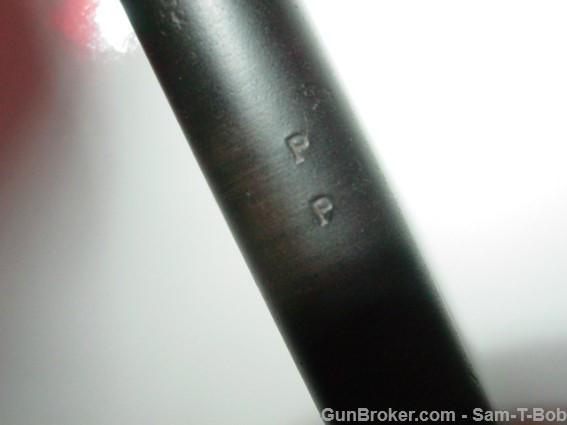

    But with that said here's a recent sale by Sam T Bob of a lined out Underwood to NPM that has a no date Marlin barrel with 2 P proof stamps on the barrel. No punch mark and in your serial range~.
    Being STB I can't say if this was the original barrel:
