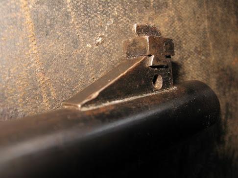

    You mention that the front sight has a dove tail insert?

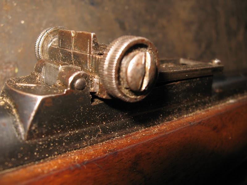

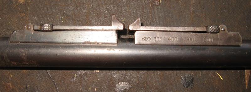

    As far I remember, all MLM and MLE long rifles have a fixed front barley corn on their sight ramp. Maybe some late models had different sight ramps?, but what I am suggesting without seeing pics, is that if this is not a custom made sight, the other possibility is that it is the front sight set up for a Charger Loading Lee Enfield. They had a dove tail to accept a considerably taller front sight insert to match with the taller windage adjustable rear.
    I have a naval marked MLM that has a HV SC marked barrel and the rear sight cap is considerably taller, I figured sighted for the Mk.VII round. Some Naval long rifles were resighted. Away from my library, but I'm thinking that there was a conversion program around 1914
    Does your rear leaf have graduations to 1900 yards? Does it have CL stamped at bottom right of leaf?
    If the front sight is too tall, your aim will be too low. Even more so if you have a regular rear sight bed and leaf, which is lower than CLLE. That would compound your problem.
    Charger loading leaf on left, regular leaf shown aginst regular leaf.
    Does your blade insert have numbers and letter marked? eg. 878E which denotes blade tip 0.878 inches above the centerline of the bore and for Enfield riflng.
    Does the front sight ramp have a drilled hole to accept the screw for the sight protector bunny ears?

    The rifle is a Canadianicon Mk 1 by BSA. (1896) This new barrel is a commercial BSA, but appears set up for the CLLE, as it does have the hole through the ramp for sight protector.
    It also has the taller rear sight cap as in your Comparison photo.
    The dovetailed front sight has no numbers stamped on it, but is lower than the one in your photo, more like a L-E No 1 Mk 111 sight.
    I am sure you have hit the nail on the head though,..............that this barrel would have had a windage adjustable rear sigh fitted at one time. It came with what appears to be a CLLE rear sight, and I presumed it had worked with that front sight. I can try a few rounds with the 215 gr, to see where they print, but would like to shoot the easier to find 174-180 gr if possible.
