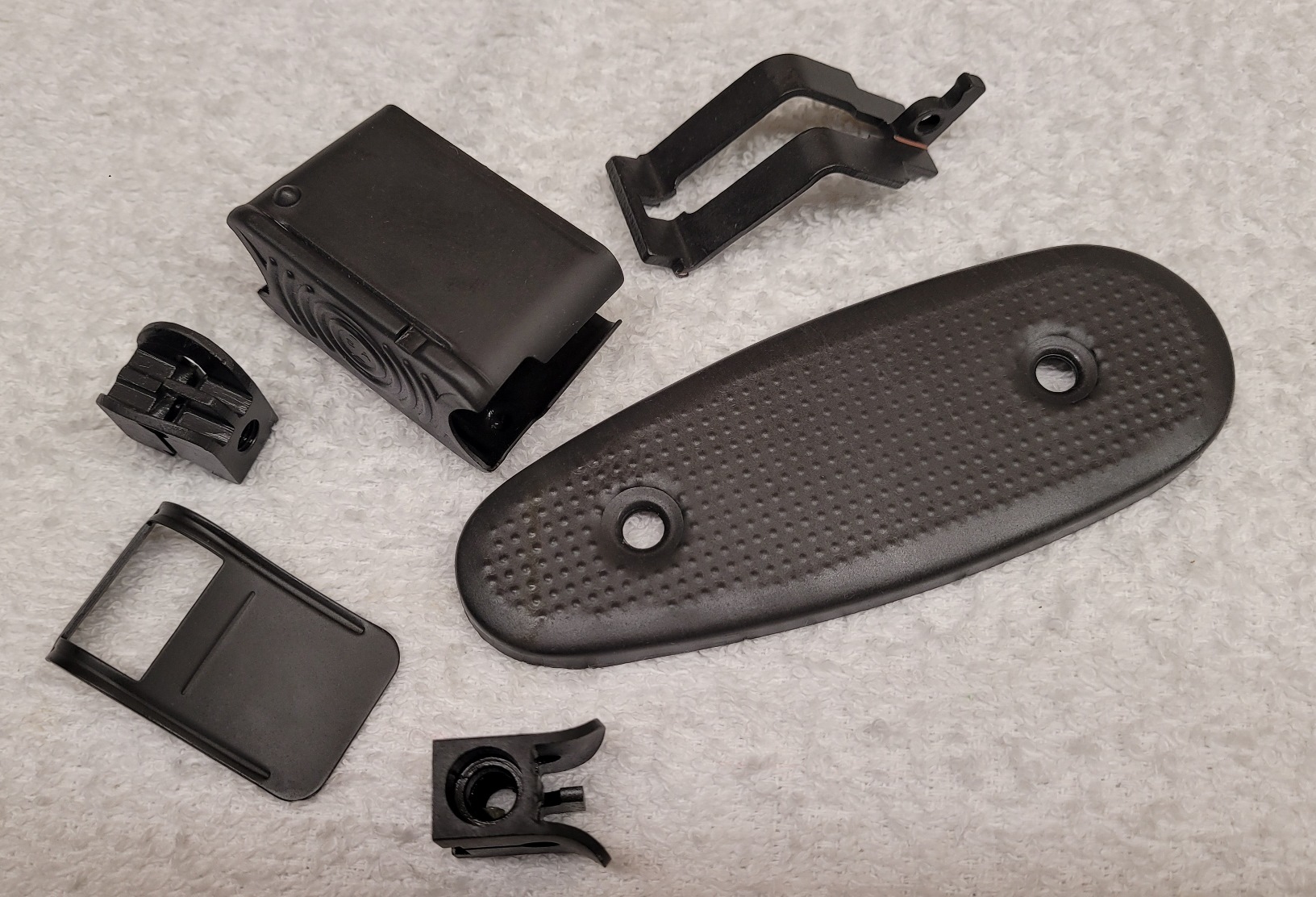

    Latest effort.
    Manganese park. Bead blaster is down so I had to use one filled with old "Black Beauty" slag and kept the pressure down to 45psi. I wasn't particularly careful on prep. This is to test the process.
    These were just some test parts. Post war South American buttplate, a SA clip left out in the rain, some sights, and a reproduction rear sight cover that came with a horrible shiny blue (yeah, the ribs look awful, ain't nothing fixing those).
    Can't wait to get the bead blaster back up and do another batch of parts or two before a receiver.

  8. #14
    Today @ 12:54 AM
    29,897
    04-16-2024
    05:13 AM
    Everything looks fine.

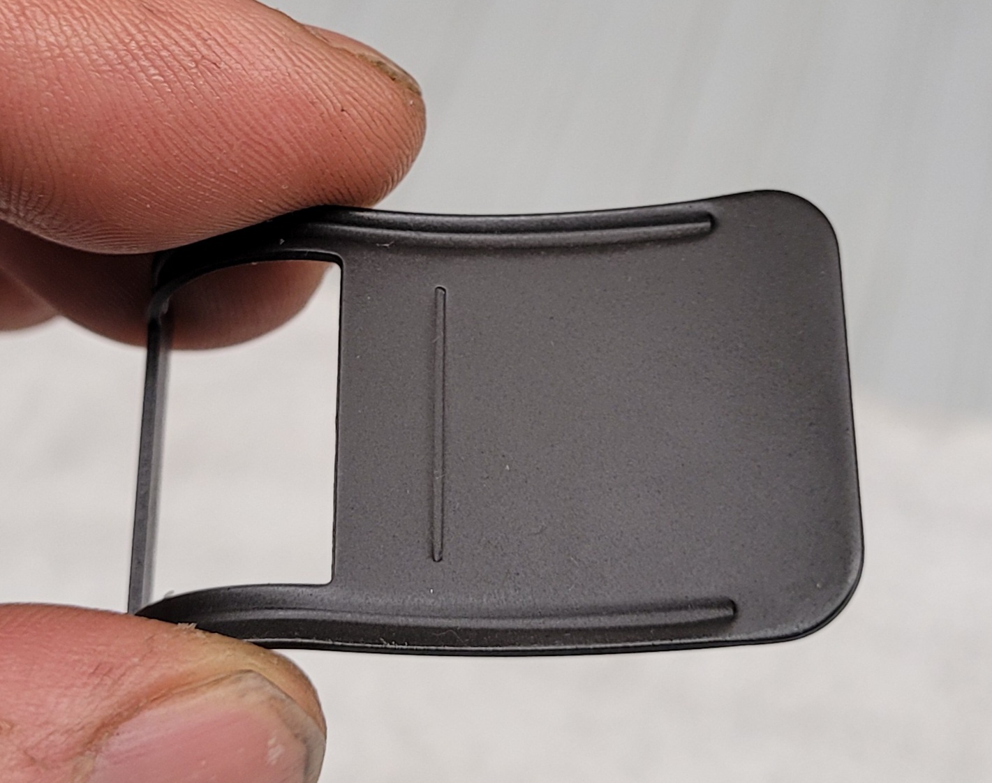

  13. #18
    Contributing Member jesse_'s Avatar
    Sep 2011
    07-30-2023 @ 07:06 PM
    Planet Earth
    81
    04-16-2024
    05:13 AM
    It looks great. Your years of work paid dividends.
    This is my first two weeks attempts.
    The part at the far right was slathered with 1944 cosmo then wrapped in foil for a week. It looks to have just the *slightest* green tint.
    I still have a buttplate and door wrapped. I will put it in the oven to see if I can accelerate/further the process.
    The front sight was manganese parked and came out much much blacker than the far left sight cover.
    You are the keeper of many secrets.....
