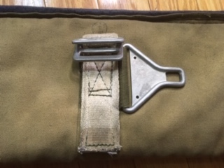

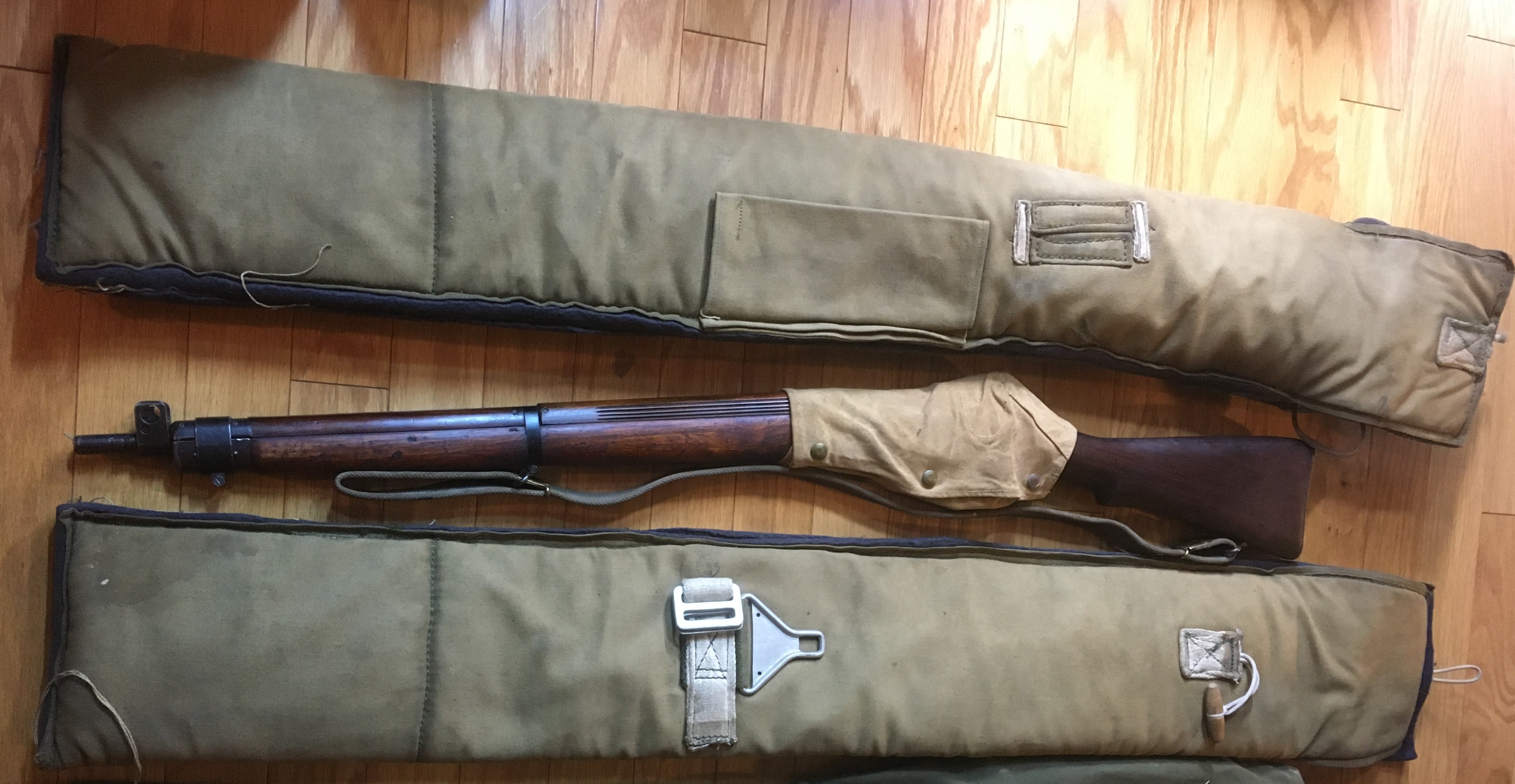

    I've had these valises for a while that have an aluminium parachute attachment. They seem to be for rifles, but I've never been able to ID them. Perhaps these are what we are talking about?

    It's a type of Griswold leg bag but not like I have or have seen before. Those are meant to attach directly to the parachutist and he lowers them on his lowering rope before landing. Where did you get those, do you remember? The marking looks like the CAL marking, somewhat.

    David mentions in his book that there are two types of rifle valises: one that goes out the door with the jumper and another less padded one for putting inside the drop container. The valise that goes with the jumper has a pouch on its side to hold the rope for lowering the rifle before landing as does yours suggesting your valise is the former, not the latter. I've attached a couple of pictures from his book showing the general layout of the valise and its hardware for your perusal. Interestingly the muzzle of the rifle protrudes downwards while the valise is attached to the jumper but rotates 180 degrees after being lowered to allow the butt of the rifle to strike first. Is there a date of manufacture on your valise? It looks slightly different and longer than the ones in the book.

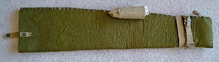

    I had one in the past; I see I'd forgotten it had the quick release strap.
    I got them from a Canadianicon auction house Wards in Edmonton in 2021. Here is the original thread where I asked about them. They are dated 1945. https://www.milsurps.com/showthread.php?t=75767

    Going by the pics in the book and Surpmil’s example, they are very crudely stitched ( by hand) to me that’s the sign of something disposable…..unlike the nicer examples that BP has.

    The originals I've seen look to be grey wool, like a doublt thickness or grey blanket. Very coarse overhand stitching too.
