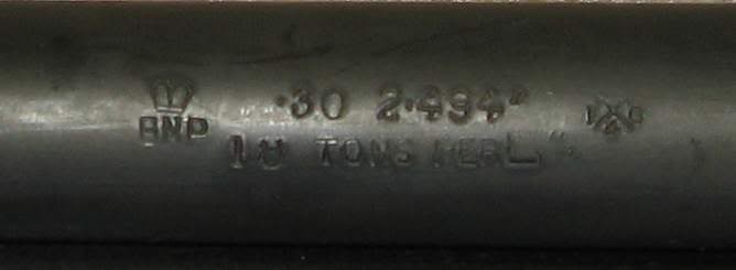

Thank you for all the compiments and observations on this rifle. I noticed the extra B on the bolt, and if you look above it, there is also a cut off 4 visible too.
I probably wont replace the stock, just a coat of RLO on it( correct period for RLO use?) I am debating on the flush, since a flush would be cool, and different, but not necessary. it was also odd that the checkered elevation was kept when switching out the pinion and bar.
I will have to check the date on the proof when i get home since my picture is not clear enough to tell
https://www.milsurps.com/images/impo...ritproof-1.jpg
Looks like it may be an "F" which would indicate it was proofed in 1955. I believe it was in 1955 that Sam Cummings of "Interarms," importd the first group of LL rifles from Great Britain. This first batch, according to Bob Seijas, were the rifles that were proofed in the date area behind the op-rod. Bob also said " maybe InterArms didn't get them all the first time around, and the second lot got marked in front." Your rifle, if proofed in 1955, would tend to support that therory.

I looked at it, and it really looks like a B. the mark on the right side of the "x" looks like a B, so that would be 1951?
The year code is the letter in the "left Angle" of what is crossed swords. The right angle always contains a "B" which indicates "Birmingham". The digit on the bottom, in your case, a "4", is the seniority of the inspector. This number will be 1 to 8. If you compare the "B" on the right to the letter on the left, I believe you will find they are not the same. Also, I don't believe any L.L. rifles were released by Great Britian until those purchased by Sam Cummings in about 1955.
The Birmingham Proof House did not start proof marking Garands at the muzzle end of the barrel until about the 1960s. The date code in the View Mark looks like an L to me which would make the proof date 1960.
Tom, Where did you get that information ?? As far as I know, based on Scott Duff's article "Garands in the Kings Service", Apr. 2002 American Rifleman, and comunications with Bob Seijas, both London and Birmingham proofed L.L. Garands. That only the first group of rifles purchased by Sam Cummings are proofed in the date area behind the op-rod. No other M1 rifles, other than that first group, are proofed in that area. An article in the GCA Journal, summer 1995, page 22) indicates that, based on the book "Deadly Business, Sam Cummings, InterArms and the Arms Trade" by Patrick Brogan and Albert Zarca, published in 1983, that it was in 1954 that Sam Cummings (Interarmco (InterArms), aquired a "consignment" of Lend Lease rifles from Great Britain through an agent in England, Cogswell and Harrison. On the other hand, Scott Duff states that it was in 1957 that Cummings was able to purchase the rifles and 1958 when they were first imported. As I am more inclined to go along with Duff, what I am saying is that Birmingham must have proofed rifles at the "muzzle end", at least as early as 1958.
As far as the "date code' on the rifle belonging to "davfink", I can only make out a straight line which appears to be seriffed on bottom and maybe the top, I can only guess what it might be. I said maybe an "F: (1955) as in Scott Duffs article, he uses an example of a "Private View Mark" showing the "date code" of "F" and and inspectors code of "1", but it may well be an "L" as you say. I would like to see a better picture of the mark.
I would appreciate any information you might have which might offer proof that Birmingham did not proof mark M1s in the muzzle area until the 1960s. I am always looking to learn more on this subject. Thanks
