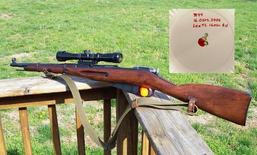

Sixteen Grains of #2400 is the Universal Load
The same 16 grain charge of #2400 is universal for all calibers as a starting load. It is mild and accurate in any larger military case from a 30-40 Krag or .303 British up through a 30-06 or 7.9x57, with standard weight bullets of suitable diameter for the caliber. This is my recommendation for anybody trying cast bullets loads for the first time in a military rifle without prior load development. I say this because #2400 is not "position sensitive", requires no fiber fillers to ensure uniform ignition, and actually groups better when you stripper-clip load the rifle and bang them off, rather than tipping the muzzle up to position the powder charge.
Similar ballistics can be obtained with other powders in any case from 7.62x39 to 30-06 size. If you don't have Hercules #2400, you can freely substitute 17 grains of IMR or H4227, 18 grains of 4198, 21 grains of Reloder 7, 24 grains of IMR 3031, or 25.5 grains of 4895 for comparable results.
However, these other powders may give some vertical stringing in cases larger than the 7.62x39 unless the charge is positioned against the primer by tipping the muzzle up before firing. Hercules #2400 does not require this precaution. Don't ask me why. Hercules #2400 usually gives tight clusters only within a narrow range of charge weights within a grain or so, and the "universal" 16 grain load is almost always the best. Believe me, we have spent a lot of time trying to improve on this, and you can take our word for it.
